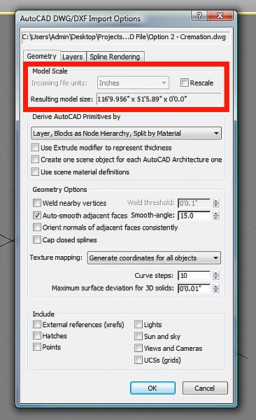

What version of Max are you running?
The screenshot below is from Max 2010.
Notice the section I've outlined in red. You may want to try Importing your CAD file again, and check to make sure the units are correct. If not, check the "Rescale" box and change the units to millimeter.
Hmmm... Gosh... I miss out that part haha...

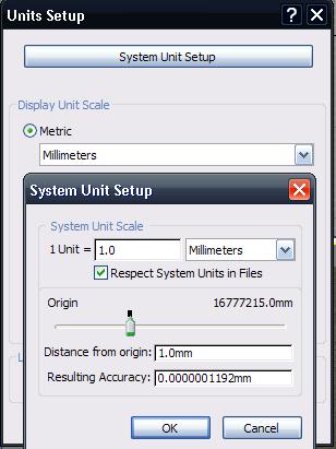

1 more question =) Is the following correct as i wanna set all to mm ?
