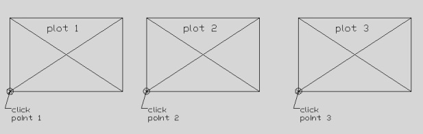

filan1a Posted July 9, 2008 Posted July 9, 2008 Here's a new question. I work in model and have lot of prints to do (look the attached pic). i would like a lisp to print by clicking the botom left corner, after i have defined the plot style with "page setup manager" all replies are welcomed. thanks. Quote

filan1a Posted July 10, 2008 Author Posted July 10, 2008 Hey guys. By myself is all right because i use paperspace, but when i receive files from other studios like architectural or electric or h/vac they usualy use model space. and the arrangement of all those in paperspace takes time. In fact when I first wrotte this thread i was thinking about asking a lisp to make a new layout with viewport by cliking at botom point. Quote
JerryG Posted July 10, 2008 Posted July 10, 2008 Even with a lisp I think you will still have the problem of different size title blocks etc. What I normally will do when I get a dwg done all in MS is block out the TitlBlock - insert into PS (2008 and 09 now have the CHNGSPACE command) Scale down by whatever there dwg scale was - then create VP and use Zoom XP. If there are multiple floor plans it is simply a matter of creating a new layout (right click layout tab and select "Move or copy" - Select (Move to End) and check the box "Create a Copy" then rename the new Layout. This will copy the VP etc so that you dont have to keep recreating them for each plan. Just personel pref - but I will then saveas and create Seperate sheets for each floor plan etc. and delete the extra tabs. Hope that helps somewhat:) Quote

pefi Posted July 17, 2008 Posted July 17, 2008 filan1a said: Here's a new question.I work in model and have lot of prints to do (look the attached pic). i would like a lisp to print by clicking the botom left corner, after i have defined the plot style with "page setup manager" all replies are welcomed. thanks. Test this: (defun c:cplot () (setq pt (getpoint "\nPick a point")) (command "-plot" "Y" "" "" "" "" "" "" "W" pt "10000000,10000000" "" "" "" "" "" "" "" "" "" ) ) It's a KISS method in practice... Przemo Quote

JONTHEPOPE Posted January 23, 2009 Posted January 23, 2009 have you tried script file ?? it's like code for learners gointo note pad and type something like this -- -plot dwgtopdf window 0,0 24,36 y y n y y save as.scr each line represents auto cad command eg: Command:Plot what device .. dwgtopdf print what window pick points now i realize this is pretty amature code but i don't happen to have any scr files here at home with me . so if you reply to this ill check at lunch and get you a working .scr file if you need it Quote
