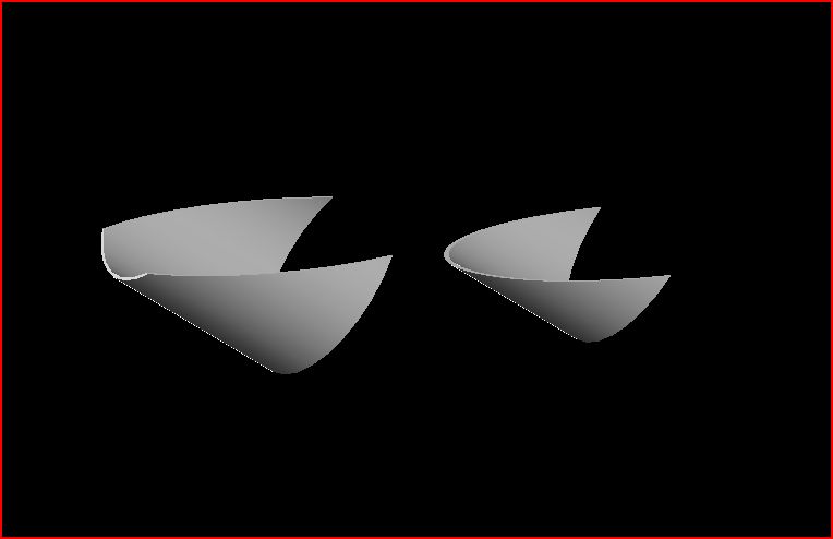

I've searched and can't find the answer I need. I need to find the area of these 2 outside surfaces. Anyone have a solution?
thanks,

here it is. one pair is (still) a solid and the other is a 'surface'
see what you can do with it. cuz I'm at a loss....:?
screen area.dwg

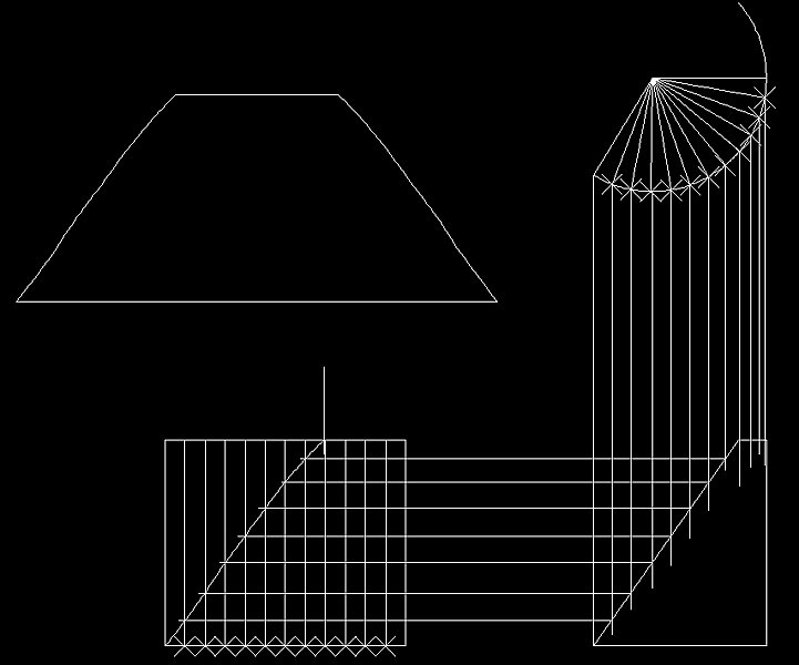

You can always figure it out the old school way. (see the attached image.) It is not automatic, but it will get the job done. I have seen some stuff that will 'unfold' meshes, maybe that will help.

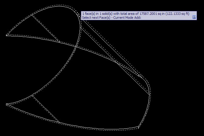

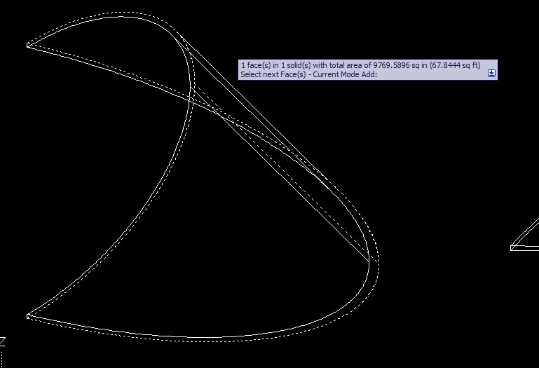

By the way, here is what the SFA routine would return when it is running properly.
THAT IS AWESOME seant! Thank you very much.
