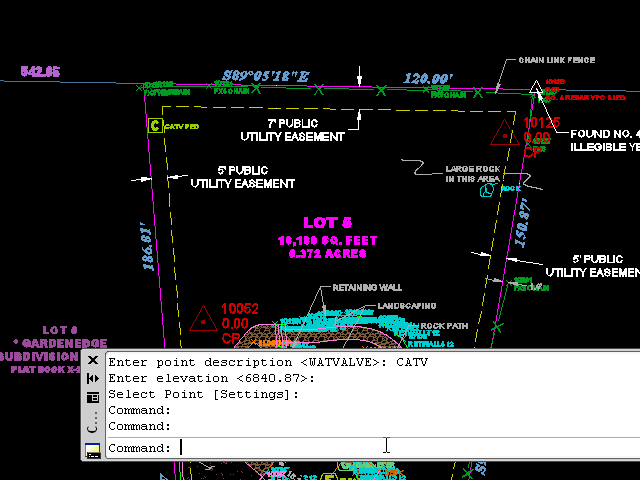

sinc Posted November 7, 2009 Share Posted November 7, 2009 Are you trying to do something like in the attached image? It's showing the SPLayOff command in the Sincpac-C3D. If you want to tackle something like this, I should warn you that it is rather tricky, and not a simple task. I would also strongly recommend that you do not try to use VBA, and instead try to use a .NET language. Autodesk is no longer supporting the COM API for Civil 3D, and you can't get to everything that way. Well, you still can't get to everything via .NET, either, so as of right now, .NET programming for Civil 3D is a nasty mix of COM and managed access. But moving forward, Autodesk is only working on the managed side, and they are not adding new API calls to the COM side. Quote Link to comment Share on other sites More sharing options...
