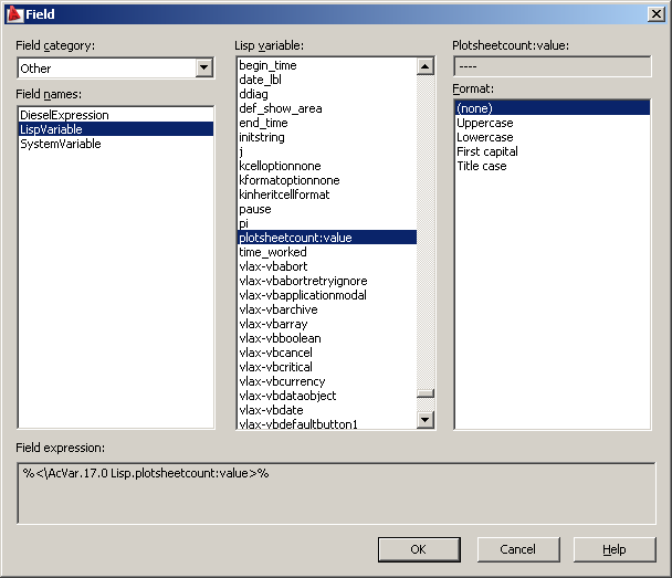

This is a plot reactor that, when plot, publish, or preview are executed, will take the total number of layouts in a drawing (layoutlist) and save the number to variable: PlotSheetCount:Value. With the use of a Lisp Variable Field, the total sheet number attribute value will be updated to display the correct number.
[ATTACH]14656[/ATTACH]

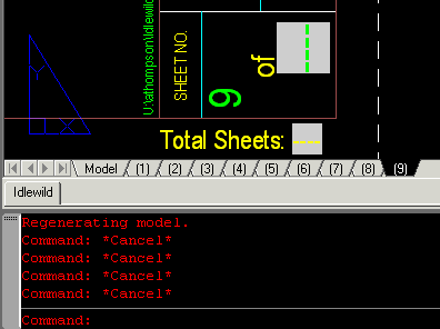

Will update if using a Lisp routine that utilizes (command "_.plot"), etc.
*** Reactor MUST be loaded every time for attribute to be updated. ***
Example (created in v2009): %%

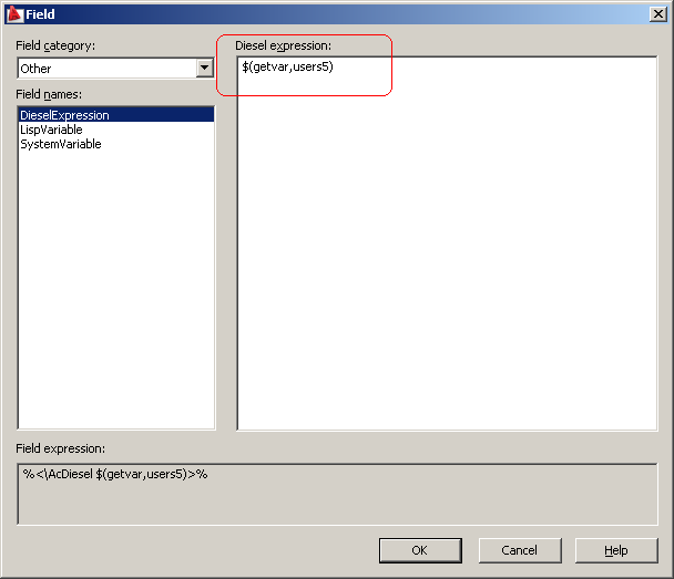

Additional version added. PlotSheetCountReactor-Diesel.lsp will update the users5 system variable. This way it will work with older versions (prior to additional of Lisp Variables to Fields and Fields completely). If you have a version older than 2005, but have RText (Express Tool), Rtext will accept Diesel expressions and this will also work.
This should cover everyone from 2000 and up.
Diesel expression: $(getvar,users5)
