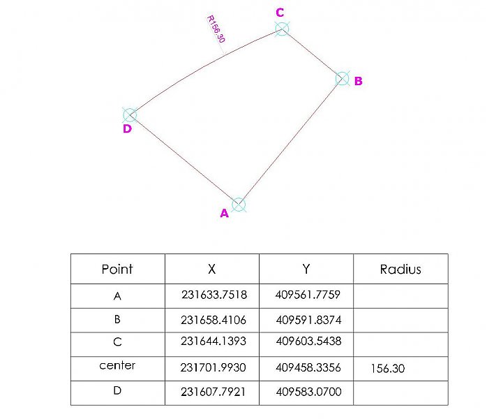

Hi, is anybody know the techniques or lisp on how to hyperlink coordinates into table? i mean when you try to generate x & y coordinates by clicking point it will update the table automatically, something like this.......instead of getting the x & y coordinates copy & paste it to table, that is annoying....

Is that points 'point' entity or something else? For example block insertion points? You can insert field inside table (see drawing). It's not so hard to write lisp which will to insert coodinates to table very quickly (pick point - pick table cell or pick first cell and pick many poits to fill table automatically) but need some more info, for example *.dwg.

there are no points or blocks on each corner of the polyline. What i i have is only polyline, i just picking each corners & center of arc. Do i have to create POINT on each corner of the polyline? or you have a lisp by just picking the polyline & it will generate X & y coordinates to the table.
Why not?
I haven't but can to write.
please if you have the time to write the code (about picking a polyline & it will generate x & y coordinates & link it to table automatically) can i have the copy. thanks Asmi
As the sketch only without chekups and other things... Choose a lwpolyline, the table and click inside the first cell. Missing rows will be added automatically. It is not fields, but works normal.

i have tried your tabord.lsp, it works fine. In my requirements i need the x & y coordinate to be on separate cell, also the i need the last digits to be 4, see the image.
thanks in advance....
