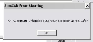

When I try to insert a .tiff image into my drawings I'm get a fatal error.

Attached is a screen shot of the error i get. I didnt attach my dwg file, but it does it in any drawing.

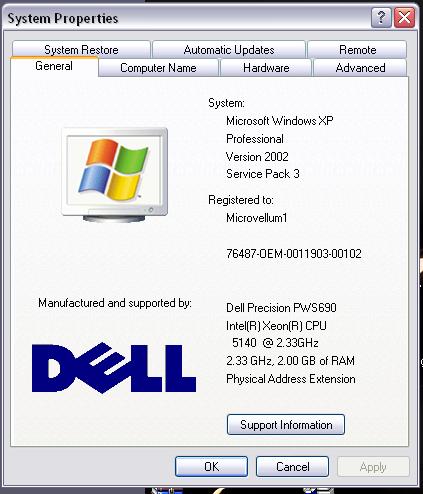

Maybe the error is memory related. What are the system specs?

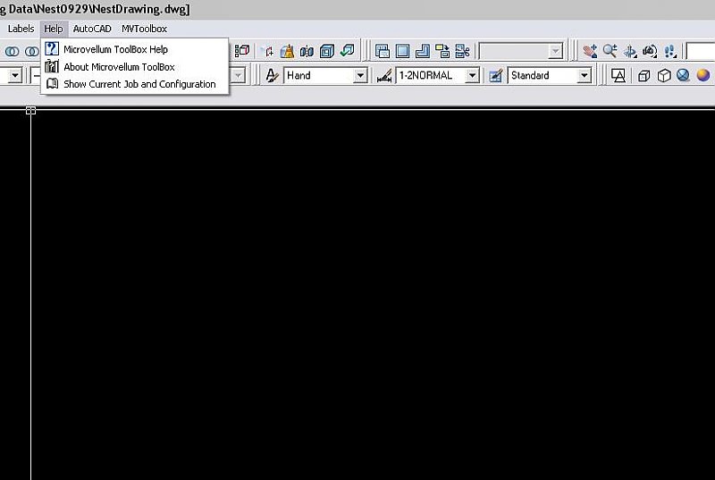

i do not have the ability to click on help :(
we use microvellum, it incorporates itself into autocad and reworks the file menu
3D work? Yeah, you might be a little light on RAM if your model is fairly complex. How big is the file?
Don't I see a Help pull-down at the top of the screen? Microvellum overrides this?

microvellum replaces help with its own help, i can access acad's help via the F1 keystroke, but cannot click the pull down help from the file menu, thus cannot click on "about" to check my service pack version.

Then just type the word About at the command line and press Enter. It should work.

a friend recommended i just google the exact error text, im going to try that now
ill post how that works out for me shortly here
