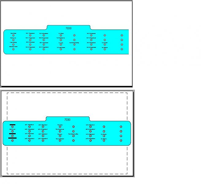

ziemerd Posted October 7, 2009 Share Posted October 7, 2009 I think I'm having the same problem. I've attached a JPG with the top picture being the Print Preview and the bottom picture is the drawing in Paper Space. I have gotten it to work just fine before but now it doesn't matter if I choose Display, Extents, or Layout. I checked the other plotter and I get the same thing. Quote Link to comment Share on other sites More sharing options...

sparkyuk Posted October 7, 2009 Share Posted October 7, 2009 might be me being a bit thick here but isnt that picture showning the max size of your plot as a dotted line and isnt it over hanging the same distance as it is cut off ?,in which case its to big for the paper you are printing to ? Quote Link to comment Share on other sites More sharing options...
ziemerd Posted October 7, 2009 Share Posted October 7, 2009 Well...I think I'm the one who is thick. I trimmed the ends of the decal to make it fit in the dashed lines and it worked fine. Thanks. Quote Link to comment Share on other sites More sharing options...
