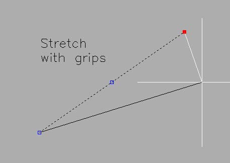

eldon Posted July 5, 2008 Posted July 5, 2008 I have just literally drawn a line or a pline then I go to stretch it in the normal way but instead of one end moving the whole thing does exactly as it would if I used the move command. What is your normal way of stretching? Do you use the STRETCH command? or do you pick the object and use the grips to stretch? If you are using the grips method, then you can cycle through the alternative commands (Stretch - Move - Rotate - Scale - Mirror) by pressing either the Space bar or Enter. Perhaps a stray digit is catching the Space bar to give you the Move command, all unbeknownst Quote

eldon Posted July 16, 2008 Posted July 16, 2008 Perhaps it is the way that you are picking the line. You must pick a line to show the Grips, pick a grip to highlight it, then move the crosshair to where you want to stretch it, and pick the final destination. If you don't highlight a grip but pick the line, and holding down the pick button, you can move the line. Quote

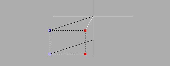

lpseifert Posted August 5, 2008 Posted August 5, 2008 You need to select the vertices by crossing for Stretch to work, either by noun/verb or verb/noun. If you select an entity by clicking on it to highlight the grips and then issue the Stretch command, you're selecting all the vertices, ergo all vertices move. Try adding this to your acaddoc.lsp file (defun c:s() (command "stretch" "C")) Quote
eldon Posted August 5, 2008 Posted August 5, 2008 I am not sure whether you are pressing the buttons in the right order to stretch with grips. First pick the rectangle and it then shows Grips. Then hold down the SHIFT button whilst you highlight the Grips you want to move. Release the Shift button, click on one of the highlighted grips and move it to where you want. You do NOT use the Stretch command in this case. Quote
