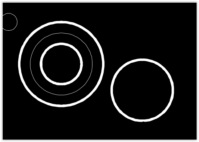

Here's a little trick I learned a while back. I needed to add thickness to a circle & found a slick way to do it. Here goes: Start by making a polygon with 4 sides. Check inscribed in circle when prompted. Next specify your radius. That will create a square. Then select polyline edit, then select fit, then width. Tah Dah! You have a circle with a global width!

The DONUT command can probably also give you a similar result. Specify the inner and outer dimensions, and voila!

I use two arcs and use PE to convert to polylines and join. I think I once saw a LISP somewhere that would do the two polyline arcs from a circle, maybe from DotSoft.

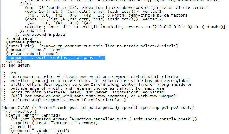

The only thing that would make it better is if it allowed you to set the width within the routine, rather than having to do after with the Pedit command. Still a time saver though.

A circle is 2*pi.
What is an arc angle 2*pi-pi/1000000 ?
A tiny gap ! one arc !
6.283182166 v's 6.2.83185307
As suggetsed by Cad64 in lisp Enter offset +ve would mean 1/2 each side -ve match existing radius etc or a combo width,off 12,0
command: arc
Specify start point of arc or [Center]: c
Specify center point of arc: 200,200
Specify start point of arc: 300,200
Specify end point of arc (hold Ctrl to switch direction) or [Angle/chord Length]: a
Specify included angle (hold Ctrl to switch direction): 359.9999
pedit L
w 5
Now to find 5 minutes
Edited by BIGAL
Try this, yes there is a very small error but can you tell ? Not sure how far I can push the 0.00000001

There's seems to be a problem. I load and run the routine, it asks me to pick a circle, I click on a circle and then it quits and says the operation has been cancelled.
Thanks but it's still not working for me. I'm not sure why a dcl is needed? After the circle is converted, it should just be a simple call for Pedit to set width. Incorporating a dcl to open a dialog seems overly complicated. Maybe I'll take a look at it this weekend and see if I can tweak it to do what I want.
Actually, it was pretty simple to add the function. I just added a single line of code at the end of dtkell's routine, before the (princ).
(command "_.pedit" (entlast) "w" pause "")
Now it does what I want. :D

That's the LISP I have, it came from CADALYST.
I'll have to check that out, thanks!
Just to be clear, there are two functions inside this routine. One is the C2P function which converts the circle to polyline. The other is the P2C function which does something else. I'm only concerned with the C2P function, so I added the line of code at the end of that section. See below.
