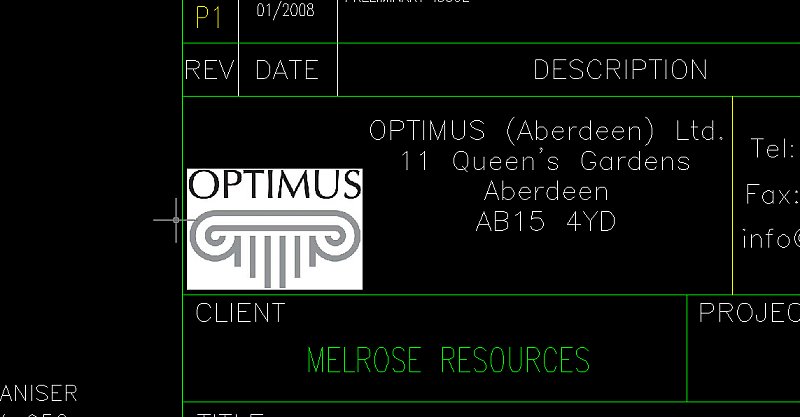

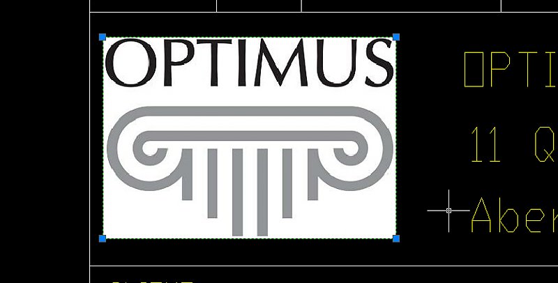

I'm using AutoCAD LT2009.
My raster image reference shows a pickable border which also shows up on plots. Strangely, this only occurs on one set of .dwg files. On the other files the image is shown without a border. I can't find any options in the properties that relate to image borders! This is a major pain because it looks terrible when plotted.
Something I noticed was that I was able to pick on and move the image with the border, but not the others. Is this a new feature in 2009? I'm wondering if it has something to do with the images having borders.
Thanks in advance.
I'll attach screenshots for reference:
The first is the raster image with the border.
The second is the image without a border.
It's not a new feature.
This 'border' and whether it displays or not is controlled by the system variable IMAGEFRAME.
Set it to 0 if you wish it to not display or plot
Set it to 1 if you wish it to display and plot
Set it to 2 if you wish it to display but NOT plot.
