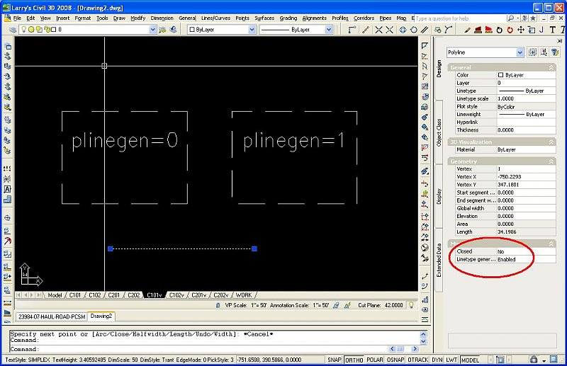

For pline ltype generation set PLINEGEN to 1
I get nothing!
See attached. Note that changing the sysvar only effects newly created plines. Existing plines can be edited thru the Properties > Linetype generation (enable or disable).

Sorry to revive an ageing thread, but is there a way to change the linetype generation setting for an object via the command line? (ie: instead of opening up the properties window and changing the setting there.) I have explored CHPROP with no luck....
try typing PEDIT at the command line, then select your polyline; and use the Ltype Gen option (setting it to On)
