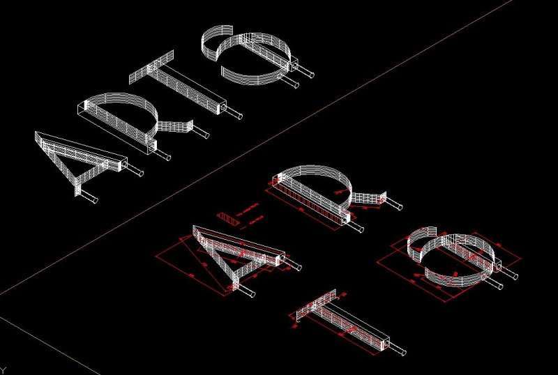

BIGAL Posted February 24, 2014 Posted February 24, 2014 My $0.05 I use text 2 geometry which makes plines etc you can squish etc very simple here is a project we just did all in stainless steel look closely its dimmed and 3d Quote
