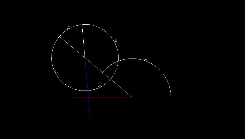

Do you mean like this?
Red line is 1st line, Green second, and blue 3rd.

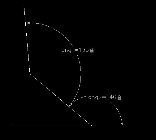

1. You could set your polar tracking, (in polar tracking settings) "Relative to last Segment" but the problem with that is you can't be at the end of the line or it won't see the line segment angle so you'll have to double the line length and start your line at the midpoint, then trim it back.
2. You could enter the absolute angle of 95.
3. A better option since you have 2010 is just draw your three lines at any angle you wish and just add a couple angle constraints later. This is how I would do it.
KC

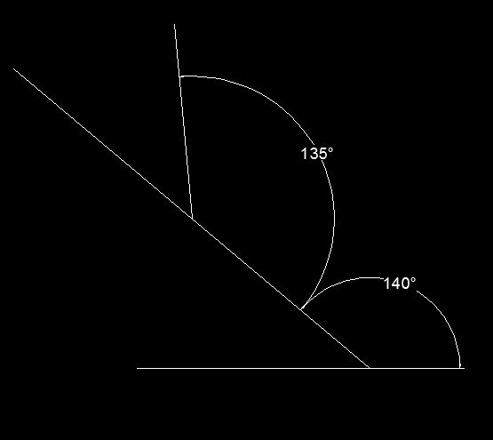

something like this
only i just clicked to make it so its not the exact angle. and i think what you are describing is correct but i do not understand it lol sry. also although i have 2010 at home i need to know how to do it on 2008 what i use at school.
p.s. ignore the circles

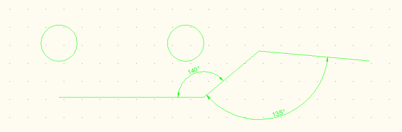

this is what i was origionally trying to do but how do you figure out what that last angle is? is there an equation. am i just missing something that should be obvious?

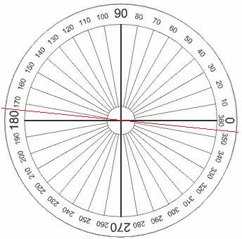

It's really just addition and subtraction. AutoCad treats angles as Counter-Clockwise=Pos and Clockwise=Neg... So,
First angle of 140
180 - 140 = +40
Second Angle 135
135+40 = 175
So, You can see on the compass that -5 is -180 from 175.
You could have also used +355 instead of -5. It's the same thing.
It's handy to have a compass and a calculator if your working with a lot of angles.
