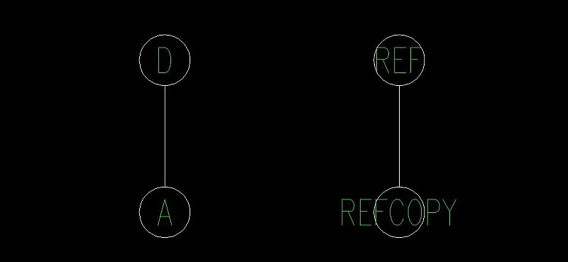

I would like to create a, for instance, double headed section arrow tag block with an attibute for the section label.
I would then like to put another attribute in the other head that contains a field that links to the value of the first attribute.
Do you see what it is yet?
I attach an image of a sample block - note that the 2nd attribute "REFCOPY" has a field linking the value property of the attribute object "REF", however it won't update now I've changed the value of "REF" to 'D'.
I have run updatefield etc.
Any ideas?
