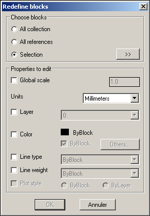

gile Posted September 17, 2009 Share Posted September 17, 2009 Hi, Instead of multiplying links to another web site, I post here my Edit_bloc routine. This function (command name: Edit_bloc) allows some changes on blocks definitions in the current drawing (the complete collection, all inserted, or a selection). All componants of the block are edited, even nested blocks and attributes. A dialog box allows to choose which properties shall be edited : global scale, units (only available on R2006 & R2007), componants on layer "0", color, line type, line width and plot style of componants to ByBlock. With another function (Edit_bloc_rep) it's possible to edit all the dwg files (wblock) of a repertory. This one must be launched from a virgin drawing and runed with "All collection" option. Edit_Bloc_3.5.zip 1 Quote Link to comment Share on other sites More sharing options...

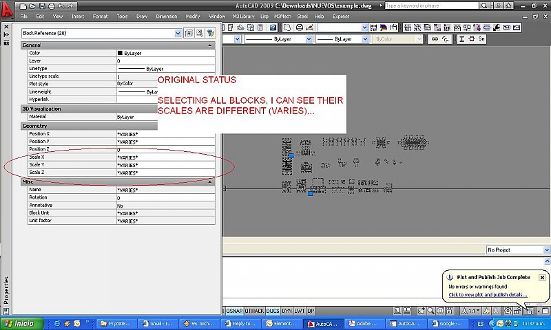

gilsoto13 Posted September 18, 2009 Share Posted September 18, 2009 It's the second time you say "The LISP doesn't redefine blocks" even it DOES !RescaleBlocks DOES redefine blocks even it doesn't explode them. While programming, it isn't needed to explode a block to resize all its components within the block definition. Sorry but I can't understand neither what you want nor the way you're working. I think you have the (powerfull) tools you need, learn how to use them... Here some files... to explain you my needs with some graphics... and a example dwg file.. If you get into the drawing... you will see 4 or 5 different scales in the blocks... 0.0394, 1, 2, 0236, etc... I need them all to be 1,1,1 but without changing their current size, name nor insertion point... When I use your rescaleblock.. It will change all of them to 1,1,1 but will just scale the blocks, preserving their name and insertion point but changing their current size.. If I use your edit_bloc and select the blocks, then select global scale=1, and taking the option none units.... (using edit_bloc.jpg) it changes block scales, but kind of converts from their original units or something but doesn´t get them to 1,1,1 (as you can see in the Properties dialog for blocks scale in the "result.jpg").. What I need (I did it manually one by one for this case) Is shown in the "what I need.jpg) as you can see there in the properties dialog box, all blocks are scale 1,1,1 and their size didn´t change. I know a lisp could retain their names and insertion points... So what I need is basically turn them scale 1,1,1 without changing their current size. example.dwg Quote Link to comment Share on other sites More sharing options...

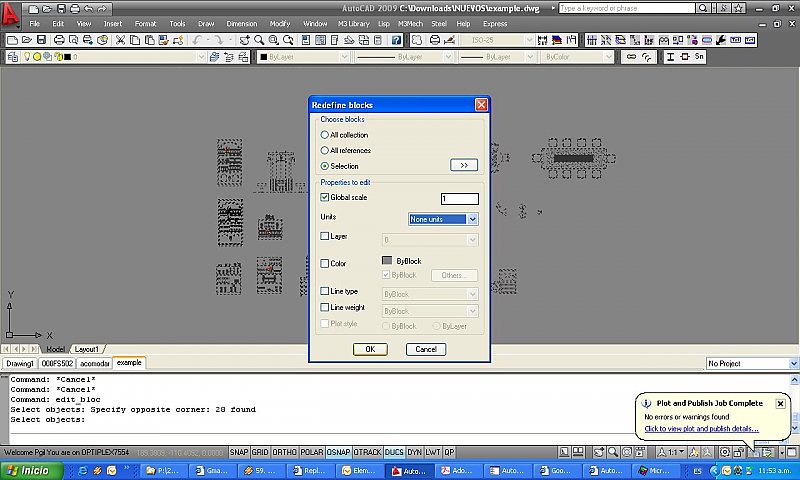

gile Posted September 18, 2009 Author Share Posted September 18, 2009 OK, RescaleBlocks needed tests if the references are uniformly scaled and doesn't treat them if they aren't. this test needed a fuzz factor on comparing X and Y scales, it's the reason why 4 blocks in your example.dwg were not treated. I never said edit_bloc set scale to 1x1x1. It only works on block definitions (and update the references), so, a global unit set to 1 will do nothing. After runing edit_bloc to set all blocks to unitless the blocks still have their insertion scaling. For example the right upper one (table and 10 chairs) which scale was 0.0276 has now to 0.7 (0.0276 x 25.4) becaus it has been inserted with this scale (or rescaled to 0.7 after inserted). Then if you run RescaleBlocks (new version) the block will be redefined with 1x1x1 scaling. (defun c:rescaleBlocks (/ acdoc blocks ss scl name def base) (vl-load-com) (setq acdoc (vla-get-ActiveDocument (vlax-get-acad-object)) blocks (vla-get-Blocks acdoc) ) (if (ssget "X" '((0 . "iNSERT"))) (progn (vla-StartUndoMark acdoc) (vlax-for b (setq ss (vla-get-ActiveSelectionSet acdoc)) (setq scl (vla-get-XScaleFactor b)) (if (and (equal scl (vla-get-YScaleFactor b) 1e-9) (/= 1.0 scl) (setq name (vla-get-Name b)) (setq def (vla-item blocks name)) ) (progn (setq base (vla-get-Origin def)) (vlax-for o def (vla-ScaleEntity o base scl) ) (vla-put-XScaleFactor b 1.0) (vla-put-YScaleFactor b 1.0) (vla-put-ZScaleFactor b 1.0) (if (= (vla-get-HasAttributes b) :vlax-true) (vl-cmdf "_.attsync" "_name" name) ) ) ) ) (vla-Delete ss) (vla-Regen acdoc acAllViewports) (vla-EndUndoMark acdoc) ) ) (princ) ) Attached the example.dwg after runing edit_bloc (All inserted, None units, Layer 0, Color, Lintype and Lineweight byBlock) and RescaleBlocks PS: IMO, you have much more work to get these blocks usable: most have their insertion point far away at 75 to 150 units and they don't seem to be the same scale (some chairs too large and others too small)... example.dwg Quote Link to comment Share on other sites More sharing options...
gilsoto13 Posted September 18, 2009 Share Posted September 18, 2009 OK, RescaleBlocks needed tests if the references are uniformly scaled and doesn't treat them if they aren't. this test needed a fuzz factor on comparing X and Y scales, it's the reason why 4 blocks in your example.dwg were not treated. I never said edit_bloc set scale to 1x1x1. It only works on block definitions (and update the references), so, a global unit set to 1 will do nothing. After runing edit_bloc to set all blocks to unitless the blocks still have their insertion scaling. For example the right upper one (table and 10 chairs) which scale was 0.0276 has now to 0.7 (0.0276 x 25.4) becaus it has been inserted with this scale (or rescaled to 0.7 after inserted). Then if you run RescaleBlocks (new version) the block will be redefined with 1x1x1 scaling. (defun c:rescaleBlocks (/ acdoc blocks ss scl name def base) (vl-load-com) (setq acdoc (vla-get-ActiveDocument (vlax-get-acad-object)) blocks (vla-get-Blocks acdoc) ) (if (ssget "X" '((0 . "iNSERT"))) (progn (vla-StartUndoMark acdoc) (vlax-for b (setq ss (vla-get-ActiveSelectionSet acdoc)) (setq scl (vla-get-XScaleFactor b)) (if (and (equal scl (vla-get-YScaleFactor b) 1e-9) (/= 1.0 scl) (setq name (vla-get-Name b)) (setq def (vla-item blocks name)) ) (progn (setq base (vla-get-Origin def)) (vlax-for o def (vla-ScaleEntity o base scl) ) (vla-put-XScaleFactor b 1.0) (vla-put-YScaleFactor b 1.0) (vla-put-ZScaleFactor b 1.0) (if (= (vla-get-HasAttributes b) :vlax-true) (vl-cmdf "_.attsync" "_name" name) ) ) ) ) (vla-Delete ss) (vla-Regen acdoc acAllViewports) (vla-EndUndoMark acdoc) ) ) (princ) ) Attached the example.dwg after runing edit_bloc (All inserted, None units, Layer 0, Color, Lintype and Lineweight byBlock) and RescaleBlocks PS: IMO, you have much more work to get these blocks usable: most have their insertion point far away at 75 to 150 units and they don't seem to be the same scale (some chairs too large and others too small)... wwoooow... It really works :0 First I made the test with the same file, and worked, then I moved to the original, but it has 1786 blocks... so I just grabbed 204 with different scales... and It worked again... So I guess it will continue working... Finally I got what I need... just need to use both your edit_bloc and rescaleblocks and I will turn all the blocks as I need them.... This will save like Tons of hours, maybe weeks of time for this task... I will let you know when I am done with all the collection.., thanks so much for all your help.... I still have to spend many hours in looking at each block and placing it in its own drawing, but without this tool, I would have take like 2 more weeks to finish, now It will be reduced to a few.. or maybe a couple hours.... About the blocks... well, I will be changing all insertion points to be at one corner or center depending of each block, also the block scale will be set to equal... and I am wblocking all to rename them using a file renamer (advanced renamer) that way each block in the collection will have its own name. What I am now trying to figure out is how to batch rename all the blocks in a drawing, so I wouldn´t need to do it outside of the drawing to avoid reorganizing them in the drawing. Also I would prefer this tool because I am thinking that I should use block names for spanish and english as I will need your lisp for turning metric blocks into english units blocks. But well... I hope someone answers that one later.. or I will do the search when I am done with all the drafting. Incredible... And just to give you an Idea, I currently have about 20 files already worked from different collections, each one has in average 1,000 blocks, this one of 1700 is just one of them.. and I still have about 10 gigabytes of some other collections in their original compressed rar files because I don´t have enough room in my hard disk to extract them all.. I am extracting... renaming, purging, auditing, reinserting and deleting... I know you will like this collection when I am done... I just got some other tools, I just found and tested one for changing all blocks in the current drawing to color bylayer, and layer 0, its was supposed to work for both at the same time, but didn´t work for both, so I kind of edit it, and splitted it in one lisp for each... and they both work now.. Also, I am using the wblockm.lsp to wblock all the blocks in the current drawing to a selected directory... and finally I am using a lisp to insert all blocks in a directory to the current drawing using a distance between them... it is the most messy lisp of all of them, due to blocks insertion points and scale... but at least I am not inserting them one by one. Quote Link to comment Share on other sites More sharing options...

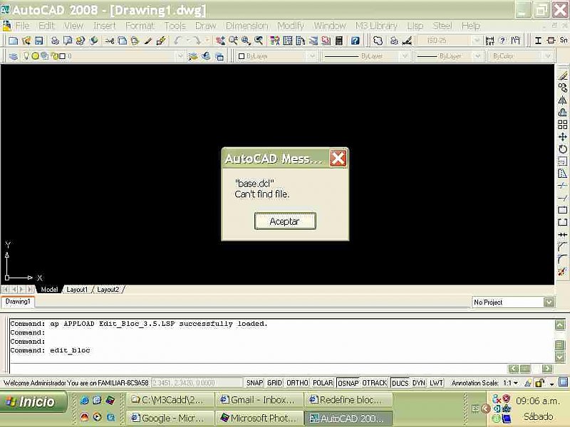

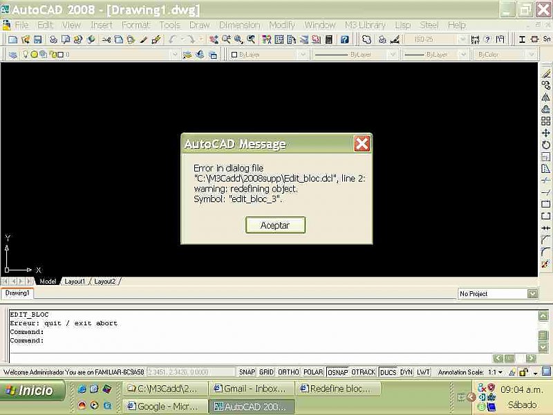

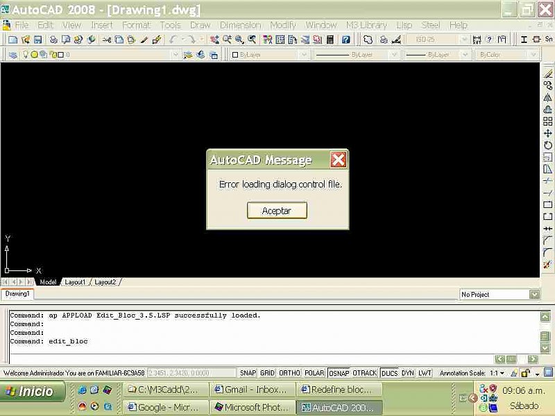

gilsoto13 Posted September 19, 2009 Share Posted September 19, 2009 Edit_bloc does this too... oops... I forgot to checkk that option yesterday... but.... you know I wanted to check that out today and I can´t use it, I got an error... I will check if it is due to all the other configuration I got... but this is the error sequence... I used it in autocad 2009 yesterday... now I tried it on 2008, could it be the reason? Quote Link to comment Share on other sites More sharing options...
gile Posted September 19, 2009 Author Share Posted September 19, 2009 It's a problem with your AutoCAD: "Base.dcl Can't find file" Base.dcl is an AutoCAD provided file where DCL controls are defined. It have to be in your search path. Quote Link to comment Share on other sites More sharing options...
gilsoto13 Posted September 19, 2009 Share Posted September 19, 2009 It's a problem with your AutoCAD: "Base.dcl Can't find file" Base.dcl is an AutoCAD provided file where DCL controls are defined. It have to be in your search path. You're right... I was changing my support path to run autocad faster on one batch task, and deleted the "\AutoCAD 2008\UserDataCache\Support" by mistake.. now It works... and also checked the layer and color bylayer and worked on all blocks without a single problem.... Now it is the most amazing lisp I've found... It will work a lot for this task... thank you very much. Quote Link to comment Share on other sites More sharing options...
