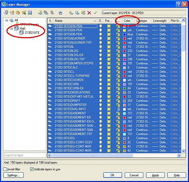

nocturne00 Posted June 23, 2008 Share Posted June 23, 2008 Hi guys; Im working on drawings which basically rely on xref for ease of work in terms of it always being updated; eg road layouts, pipe layouts, Land Topo. on presentation of development plan drawings there are certain portions that needs to be in greyscale to put emphasis on an xref whose lines are at 100% screening. vice versa for the other xrefs in terms of emphasis for other sheets. Is there a way to present in greyscale entire xrefs without changing the colors of the layers in the xref itself? the only solution i do is to make a separate xref drawing of road, pipe layout and structure which is entirely on a single color i setup on 80% screening; so noob ^_^ there is a way I browsed in the forums but it uses autolisp. I just wanted to know if autolisp is the only way to make this happen TIA Quote Link to comment Share on other sites More sharing options...

lpseifert Posted June 23, 2008 Share Posted June 23, 2008 If the color of the entities in the xref are 'bylayer'... Layer Manager > use the tree to filter the xref layers Select all the xref layers (Ctlr+A) Change the color to grey. If you want the colors to remain grey, set Visretain =1 Quote Link to comment Share on other sites More sharing options...
nocturne00 Posted June 23, 2008 Author Share Posted June 23, 2008 i dont really use STB, im more on the CTB. Great help seifer; thanks for the help. it saves me a lot of time instead of making new greyscaled xrefs...^_^ I thought of this method once but never tried it thinking that when i reload the xref, all colors will revert to its original but I really thought there was a command for this ^_^ Thanks again Quote Link to comment Share on other sites More sharing options...
lpseifert Posted June 23, 2008 Share Posted June 23, 2008 This should work in most cases... change the "9" to what color you want (command "-layer" "c" "9" "*|*" "") Quote Link to comment Share on other sites More sharing options...

ollydoyle@hotmail.com Posted March 25, 2021 Share Posted March 25, 2021 On 10/29/2017 at 11:10 AM, tombu said: With the current version of AutoCAD you can "Xref In Greyscale" even if nothing in the Xref is set ByColor. How do i do this, where is this option, and does it function in model space or just plotting Quote Link to comment Share on other sites More sharing options...
tombu Posted March 25, 2021 Share Posted March 25, 2021 6 hours ago, ollydoyle@hotmail.com said: How do i do this, where is this option, and does it function in model space or just plotting With the XREFOVERRIDE (System Variable) set to 1 the visual properties of the objects on the external reference drawing are set to ByLayer and every external reference layer can have its own set of layer overrides allowing you to set the xref layers to whatever properties you want like changing color. Quote Link to comment Share on other sites More sharing options...
