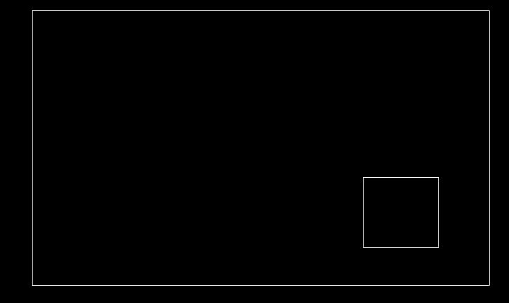

Is there a lisp to get the Center of Gravity for an area
and if it is possible getting the CG for several areas
I am thinking that, that lisp draws a point in CG and a leader showing the coordinates (or what ever) for pointing to the CG
as attached
Thanx

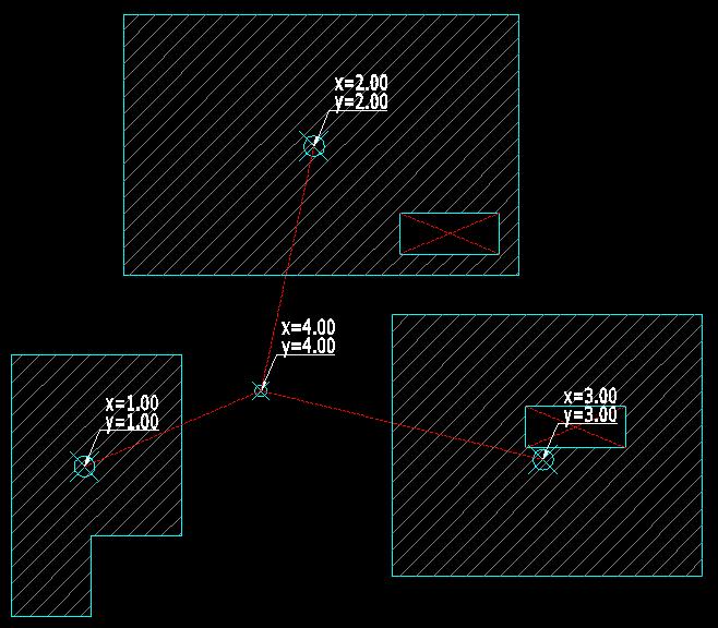

Just a footnote the centre of a hatch pattern is not the centre of gravity for the 3 objects shown.
If you extrude the objects and subtract the holes then list object you will get the true centre of gravity. this works for concrete tilt panels not sure how then to get centre gravity of 3 panels combined. 1st principles maybe for centroid.

that what I doing but
I am searching for a lisp for saving the time for extrude of each area
but i cant get the CG for more than one area, in that case i have to use another program looks like SAP or what ever
I want to do every thing in AutoCAD
Thans all

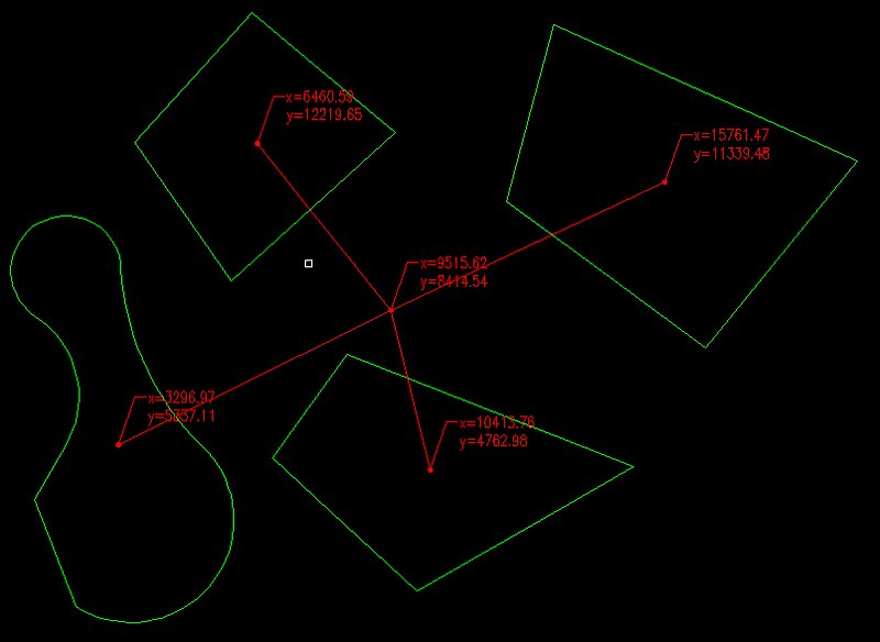

Thanx ASMI
that lisp is very good
Could that lisp get one CG for the selected objects
Regards

I can add leaders with coordianates, but I dont't know text size you need. Or you want request for text size and circles diameter :?:
what a great lisp
refer to the leader and text, can you use the current styles for dim and text.
refer to selecting objects, is it posible to select a pline? or click inside the area for avoiding any void in shape (looks like upper shape in attached pic)
thanx
Ok. Maybe tomorrow, today there isn't time.

Is it good? Coordinates in the current UCS.
Thank ASMI
i tested it and work fine till now

   ); end setq
           ); end progn
 ((eq "AcDb3dSolid" (vla-get-objectname obj))
    (setq cCen(vlax-get obj 'Centroid)
   cVol(vlax-get obj 'Volume)
   cmvList(cons(list cCen cVol)cmvList)
   ); end setq
           ); end progn
  ); end if
); end foreach
   (if
     (and
cmcList
(/= 1(length cmcList))
); enad and
(setq gCen
       (list
    (apply '+
       (mapcar '*
   (mapcar 'caar cmcList)(mapcar 'cadr cmcList)))
    (apply '+ (mapcar 'cadr cmcList))
    ); end /
    (apply '+
       (mapcar '*
   (mapcar 'cadar cmcList)(mapcar 'cadr cmcList)))
    ); end /
  ); end list
      enPt (polar gCen(/ pi 3)
     (* (getvar "DIMTXT")(getvar "DIMSCALE") 5))
      ); end setq
(command "_.qleader" "_non" gCen "_non" enPt "" "" "#" "")
(vla-put-TextString
    (vlax-ename->vla-object(entlast))
    (strcat "x="(rtos(car gCen)2(getvar "DIMDEC"))
     "\\P"
     "y="(rtos(cadr gCen)2(getvar "DIMDEC"))
           "\\P"
     "z="(rtos(cadr gCen)2(getvar "DIMDEC"))
     ); end strcat
    ); end vla-put-TextString
(foreach pt(mapcar 'car cmcList)
  (command "_.line" "_non" pt  "_non" gCen "")
  (setq enPt(polar pt(/ pi 3)
     (*(getvar "DIMTXT")(getvar "DIMSCALE")5)))
  (command "_.qleader" pt enPt "" "" "#" "")
  (vla-put-TextString
    (strcat "x="(rtos(car pt)2 2)
     "\\P"
     "y="(rtos(cadr pt)2 2)
"\\P"
     "z="(rtos(cadr pt)2 2)
     ); end strcat
  ); end foreach
); end progn
     ); end if
(if
     (and
cmvList
(/= 1(length cmvList))
); enad and
(setq gCen
       (list
    (apply '+
       (mapcar '*
   (mapcar 'caar cmvList)(mapcar 'cadr cmvList)))
    (apply '+ (mapcar 'cadr cmvList))
    ); end /
    (apply '+
       (mapcar '*
   (mapcar 'cadar cmvList)(mapcar 'cadr cmvList)))
    ); end /
  ); end list
      ); end setq
(vla-put-TextString
     "\\P"
"\\P"
     ); end strcat
(foreach pt(mapcar 'car cmvList)
  (vla-put-TextString
     "\\P"
           "\\P"
     ); end strcat
  ); end foreach
); end progn
     (mapcar 'setvar (list "OSMODE" "CMDECHO")(list oldSnp 1))
     (vla-EndUndoMark actDoc)
     ); end progn
   ); end if
 ); end of c:gec
i found one more good lsp with short code...
this lsp mark centriod of region... with circle...
know i want to move my ucs to region centriod... then mass property driectly into cad as a text
some one know about
massproperty.dwg
RCG.lsp
