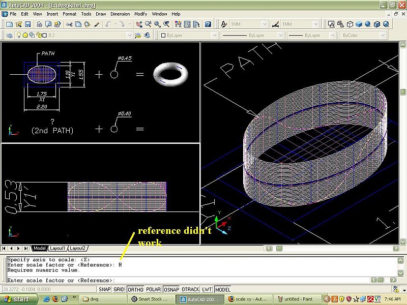

ica_cici Posted September 14, 2009 Posted September 14, 2009 Hi, does any one know how to scale profile in x,y direction? Quote
ReMark Posted September 14, 2009 Posted September 14, 2009 I just saw a reference to a LISP routine that allows the user to scale an entity differently in the X and Y directions posted by one of our forum members (Tiger). I'll have to see if I can find it for you or maybe she can repost the link herself. Quote
ica_cici Posted September 15, 2009 Author Posted September 15, 2009 Well, Luminous Being I really appreciate your help and looking forward the LISP. I need it to scale a path in several sizes for several 3D solid objects. Hope the LIPS will help to short it out. Quote
lpseifert Posted September 15, 2009 Posted September 15, 2009 Hi, does any one know how to scale profile in x,y direction? You could make a block of the profile and insert it at an exaggerated Y (or X) scale. Essentially, that is what the app found here does... http://www.cadtutor.net/forum/showthread.php?t=14355 Quote
ReMark Posted September 15, 2009 Posted September 15, 2009 Here is the link to the thread I mentioned. Look for Tiger's post of the SCALEAXIS.LSP routine. Do you know how to run a LISP program? http://www.cadtutor.net/forum/showthread.php?t=23441&highlight=scaleaxis.lsp Quote
ica_cici Posted September 15, 2009 Author Posted September 15, 2009 Hi Ipseifert i've been trying make a block of the profile and insert it at an exaggerated x and y scale, but it's need to calculate the scale factor first to get the second dimension and the result not precision. And for the LISP, first i copy the SCALEAXIS.LSP routine to the active drive and load it with autolisp. But "the reference" at the command line didn't work so i couldn't input the second dimension in it. What should i do ReMark? Quote
ReMark Posted September 15, 2009 Posted September 15, 2009 Sorry but I have not had an opportunity to use that particular routine. I'll have to try it out myself first. Quote
ica_cici Posted September 16, 2009 Author Posted September 16, 2009 Here is the picture, The path size are X1=1.75 Y1=1.10 Y1'=0.53 profile to extrude is a circle D=0.45 and I need to scale this path as X2=1.60 Y2=1.00 Y2'=0.50 profile to extrude is a circle D=0.40 Hope you can help! Thanks. kihei.dwg Quote
ica_cici Posted October 15, 2009 Author Posted October 15, 2009 Hi, it's me again. I'd seen a thread at http://www.cadtutor.net/forum/showthread.php?t=23441&highlight=scaleaxis.lsp and one of the newbie "stianhaugli" said about fit.lsp. So I just go to download this program and try to my path, and it works. Now i can scale my path in x and y directions, so need no more time to make the new one in different size. If you have problem with complex path or shape but need to make it in several sizes this lip will help. You can download it at www.xordesign.com and it's definitely free. Thanks everyones and stianhaugli! Quote

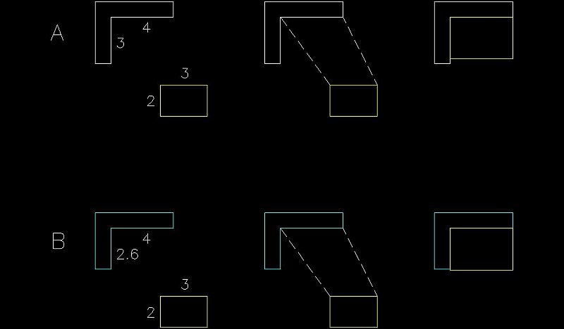

rocneasta Posted October 15, 2009 Posted October 15, 2009 i didn't read it as properly as i should, but if you have a reference and you want to SC something accordingly why not just use ALIGN - it aligns and if you want scales the object by defining reference points. sry if i totally misunderstood the point being raised Quote
ica_cici Posted October 16, 2009 Author Posted October 16, 2009 Thanks to you too ReMark Actually need to scale in x and y directions, for example you have a square with size 2 X 2 need to scale in x & y axis so get the second size 2.5 X 3. Is align can do it rocneasta? thanks. Quote
ReMark Posted October 16, 2009 Posted October 16, 2009 Let's use your 2x2 block example. Run the INSERT command. When the dialog box (Insert) comes up look in the middle. See where it says SCALE? You can specify the scale on-screen or you can type in a scale factor in the boxes for X, Y and Z. Let's type something. For X input a scale factor of 1.25 and for Y input a 1.5 scale factor. Click the OK button then insert your block. Using the DISTANCE command measure across the bottom and then across one side. The measurement in the X plane should be 2.5 while the measurement in the Y plane should be 3. Agreed? If you want to use the ALIGN command you may do so as well. Warning: The results you get with the ALIGN command may not be what you expected. Quote
ica_cici Posted October 19, 2009 Author Posted October 19, 2009 Yup, but still don't understand how is the align command work? Quote
ReMark Posted October 19, 2009 Posted October 19, 2009 From your AutoCAD Help files: ALIGN "Aligns objects with other objects in 2D and 3D." "You can move, rotate, or tilt an object so that it aligns with another object." And yes, there is a scaling option. The results from scaling may not be to your liking. Here is an example. Look at row A below. We are going to align the rectangle with the "L" shaped object. Note the dimensions depicted in the image on the left. The center image indicates the reference points to be used during the ALIGN command. The image to the right depicts the results. Note that the rectangle does not "fit" as we might expect. Now look at row B. Same procedure. Note the dimensions used this time on the "L" shaped object. Reference points stay the same. But look at the end result in the image on the right. Looks more like we expected right? Why? Well, it's the math. I think you can figure it out, right? I should have been just slightly more exact with the dimension of the inside leg of the "L" shaped object. I used 2.6. I probably should have used 2.6666666666 but you do see my point right? Quote
ReMark Posted October 19, 2009 Posted October 19, 2009 The command sequence for ALIGN. Command: align Select objects: 1 found (rectangle) Select objects: (no other selection; press Enter) Specify first source point: (top left corner of rectangle) Specify first destination point: (inside corner of "L") Specify second source point: (top right corner of rectangle) Specify second destination point: (lower right corner of "L") Specify third source point or : (no slection; press Enter) Scale objects based on alignment points? [Yes/No] : Y Quote
