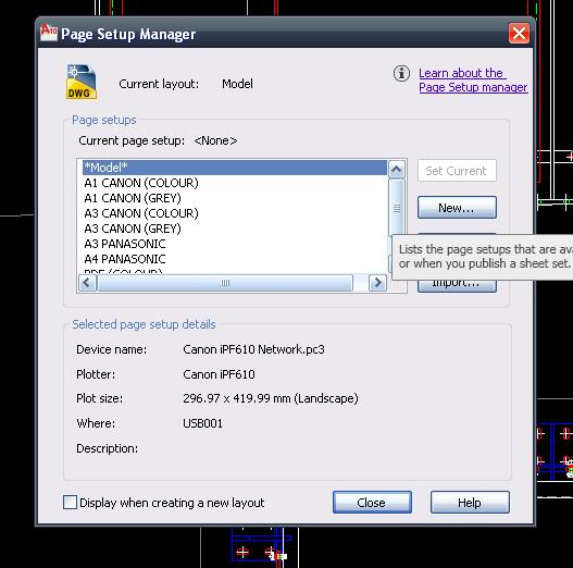

Use the page setup manager to setup all your outputs for printing and save it to your dwt file.

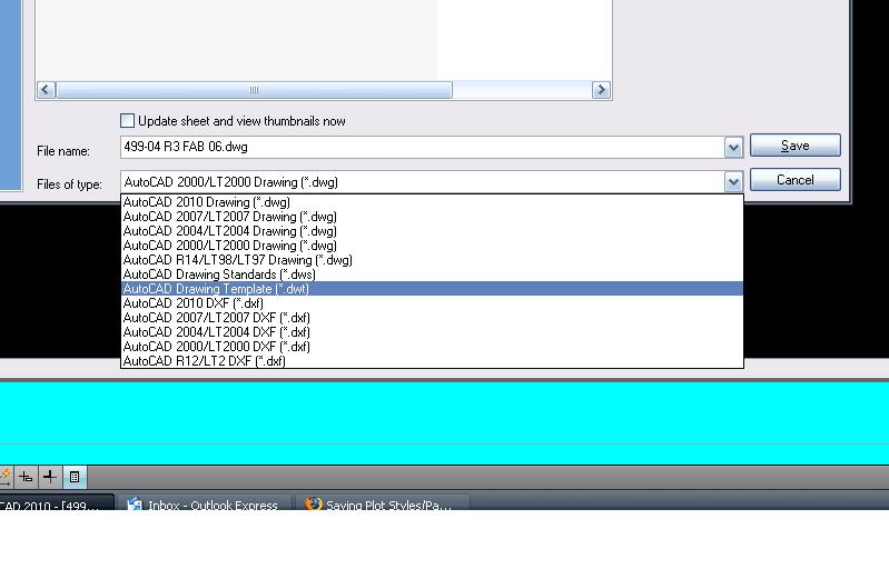

Awesome thanks, so i ve got the page setup manager settings sorted but how do I save it to my dwt file? and can i use it for drawings that i open up that arnt from templates?
Basically a dwt file is your startup template file that you can use.
You should set up all your dimension scales, text styles, plot styles, layers etc as save it in a single template.
That way anytime you start a new drawing, you can select that startup template and it saves you changing all the settings again.
To make a dwt file, set up all the styles, layers, print setups etc and when you go to save the drawing, from the dropdown menu below the file name select .dwt (template)

You can also import PageSetups with "psetupin".
