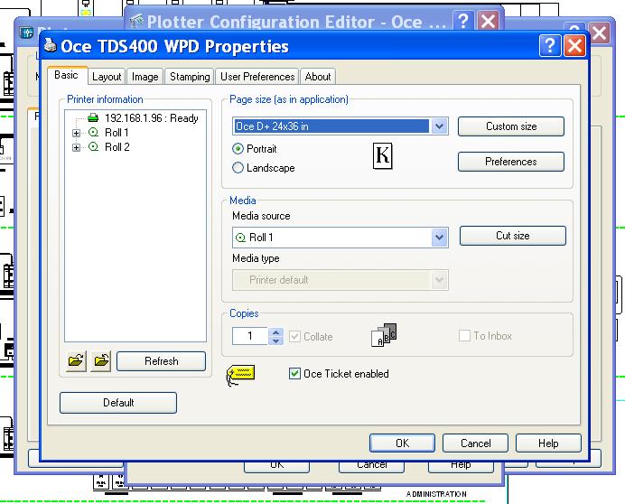

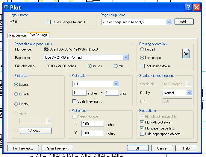

My boss purchases an OCE TDS 400 plotter a few months ago. WE are using the OCE windows Driver to print. I created the PC3 file so it would keep the printing setting, but the “DRAWING ORIENTATION” in AutoCAD 2004 shows landscape but when I click on Properties it show “PORTRAIL”. I have saved the setting and each time I have to go and change it to landscape under properties. It is not keeping the setting.
not even the CTB file
How can I keep the setting so I do not have to change it every time!:?

Setup: Using the biggest border size 36"x48" I was able to easily plot (maybe) because the first roll has 36" paper...

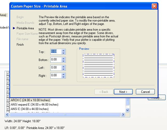

I started getting problems when I went to half size or 18" x 24". The PC3 given to us just doesn't work right while it goes to the currect roll it continues to cut off (about 1/4") info along one side. By using an old pc3 from the other plotter I was able to get the display correct but in goes to the first roll all the time.
I have checked my existing PC3 to insure that the size I ask for goes to the correct roll (in my case, roll 2 or 24") but with no luck. I get the 18"x24" drawing centered on the 36" wide paper or roll 1...:shock:
I created this user size because it wasn't included on the Oce PC3 as well.

Adjusted the Rolls and placed 24" in roll 3.
Next fixed the Oce pc3 to insure it went to roll 3 with
NO trim edge
