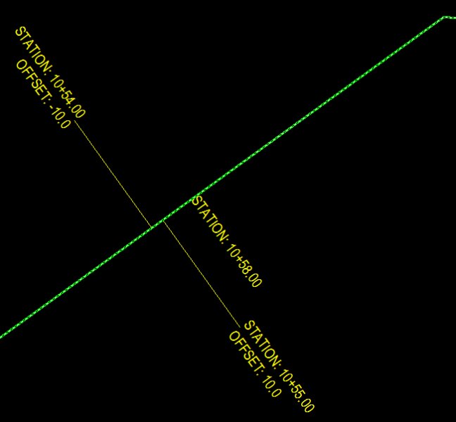

Hello to all
can any one help to draw chainage for equal distance on a polyline as in attached jpg

I believe this has been discussed a few times and routine(s) have been posted. Try searching for "stationing" which is the U.S. equivalent to "chainage".
Hi, you can use block, create a line in block then use measure command,type block, block name and create the chainage line base on the measurement you want.

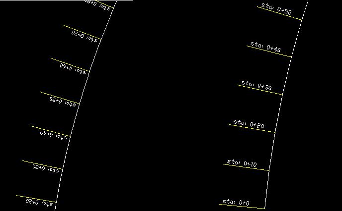

Hi, me again. I am using the above routine quite often now,
I have tried and tried to change the code to rotate the text by 180 degrees without success. If there is anyone out there who can do it quickly, it would be greatly appreciated. It takes a long time to manually rotate text.
many thanks
Cymro
This part including the rotation text for the Att. text tags .
(vla-put-rotation at_obj (/ pi 2)); <-- this is 90 degree to make it 180. replace the (/ pi 2) to pi
And when the routine asks you for rotation, hit NO to let the routine gets your angular degree that you added to the routine.
Hi thanks for getting back,
I may not have explained myself fully.
What I would like is when asked for text perpendicular to pline the output is rotated 180 to what is produced at present.
The left is what the code produces after confirming text rotated perpendicular to line, the right is the output that i would like.
Hope someone can help
many thanks
Stephen
It seems you want to "reverse" the polyline first. There are a few things which can do such, as a sample see alanjt's over here.
