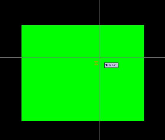

alanjt Posted September 10, 2009 Share Posted September 10, 2009 I agree in part Alan.. but I needed the selection set to iterate through the circles in case the circle was "underneath" another object. But (setq Alanjt (vl-list->string '(71 111 111 100 32 73 100 101 97))) LOL As you originally said, it's more a point than idea. I like the idea behind it, but it won't display the circle if behind something. You can near snap to it, but you can't see what you are snapping along, as shown in my attached image (circle behind solid hatch). Quote Link to comment Share on other sites More sharing options...

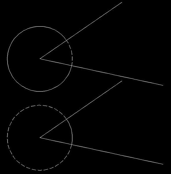

alanjt Posted September 11, 2009 Share Posted September 11, 2009 Yes, but if you are using an intersection with a line/other entity (which I did when testing), the same problem occurs Such as this? I've sent the circle back and lines to the front with draworder. BTW, why do you keep ending your statements with the ? Quote Link to comment Share on other sites More sharing options...
Lee Mac Posted September 11, 2009 Share Posted September 11, 2009 I found that without that check on the circle parameters that it would not point to the circle entity if the circle was at the back on draworder o:) Quote Link to comment Share on other sites More sharing options...
alanjt Posted September 12, 2009 Share Posted September 12, 2009 I found that without that check on the circle parameters that it would not point to the circle entity if the circle was at the back on draworder o:) See, that's what I was wondering. I didn't have that issue after removing ssget portion of code. I wonder why you encountered the issue where I was able to break the circle just fine. It's not a big deal, that portion of the code just struck me as strange and I was curious as to why you put it in. I'm not trying to insult you or you code, I was just curious as to the reason between those two (). Quote Link to comment Share on other sites More sharing options...
