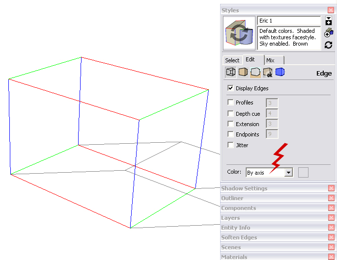

Now, if you have faces that will not fill in then the cadd is off. If you did not draw the dwg then there is a 99.9%+ chance it is off in some way. The best way to check is to turn on your color by axis. This will show any X, Y or Z lines as red, green and blue. See attached picture. The setting is in your styles dialog. If your line is slightly off axis it will cause a face not to close as it would not be coplanar.
