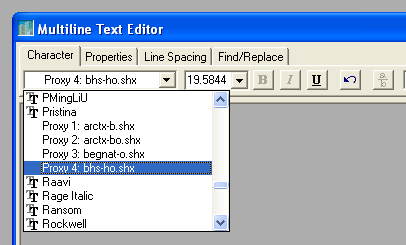

eldon Posted October 24, 2015 Share Posted October 24, 2015 It shows up for me as a proxy font. Quote Link to comment Share on other sites More sharing options...
tzframpton Posted October 24, 2015 Author Share Posted October 24, 2015 Eldon nailed it. Joy, please refer to these screenshots. You do have everything working based on this screenshot: http://i.imgur.com/aCUt17m.png But, your "MTEXT" has some weird crazy Proxy override shown here: http://i.imgur.com/ukwl1l7.png Fix the proxy issue. Wow, what a fiasco this was. Quote Link to comment Share on other sites More sharing options...
