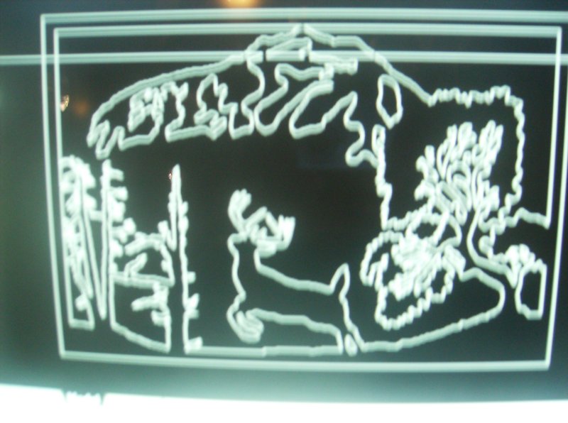

nate Posted August 31, 2009 Share Posted August 31, 2009 Hi again..I'm using autocad 2002. I'm having problems getting my files to load on the plasma table. What is happening is that I am using dxf files from another person and adding modifications to it. When I load the file to the burn table an error comes up saying layers probably do not match. How exactly do I get the layers to match or just have one layer. I typed change in the command,then selected objects, then selected properties,then selected layers and changed them to 0..Is this right or is there more to it. I'm trying to learn this on my own and occasionaly run into problems. Things I add to the drawing will show on the screen but the other objects don't. Please Help Quote Link to comment Share on other sites More sharing options...
ScribbleJ Posted August 31, 2009 Share Posted August 31, 2009 The way your using the 'change' command is correct but understanding exactly why your getting an error about the layers not matching is a bit vague. Maybe you have some entities that have colors, line types, etc. that are set by color rather than ByLayer. Give us a more descriptive explanation about your problem. Quote Link to comment Share on other sites More sharing options...
nate Posted August 31, 2009 Author Share Posted August 31, 2009 I have some dxf files from another person. I have been trimming and breaking where needed to place the objects in my drawing. The lines I add show when I load the file to the cnc burn table but the objects from the other person does not. This usually results in an error message coming up saying layers probably do not match. I use R12 dxf file out, name the file, send the file to memory stick and load on the burn table. I have also had it come up as error multiple layers..Our burn table converts dxf to g-code.. Quote Link to comment Share on other sites More sharing options...

nate Posted September 1, 2009 Author Share Posted September 1, 2009 There are no blocks. I open the folder containing the dxf files of the objects the guy sent. I then copy and paste the object(s) I want to use in my drawing. I then have to trim and break the object(s) to go with my lines to make a silhouette. I'm making wall art and gates using mountains,wildlife and trees. If I just use his objects individually they load right up but as soon as I do any mods to it the error comes layers do not match. I am not to keen on the software of the burn table. We select Cad import by MTC on the touchscreen of the cnc burn table to load up the files. As far as xrefs go I am waiting on the kids to get to bed so I can think in peace. I'll open up the drawing and see if I can find any on the file. Will get back momentarily if I can it may be tommorrow before I can. I am going to try and reload the program after I do the change layers to 0 deal and see if that works Quote Link to comment Share on other sites More sharing options...

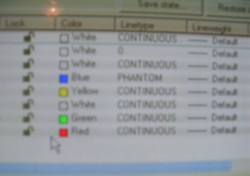

nate Posted September 1, 2009 Author Share Posted September 1, 2009 Here are some screen shots of the drawing. there are eight layers in the original. I went in and was able to individually delete 6 layers but layers 0 and 1 were not able to be deleted for reasons being cannot delete layers containing objects,layers 0 and defpoints,the current layer or xref- dependant layers. Could I compress the file and post as a zip,would that bring it down to 250kb Quote Link to comment Share on other sites More sharing options...
nate Posted September 1, 2009 Author Share Posted September 1, 2009 tried audit and purge but to no avail. Beginning to get a little upset to think that a software program is whooping my butt.. Quote Link to comment Share on other sites More sharing options...
nate Posted September 1, 2009 Author Share Posted September 1, 2009 The audit found no errors. I deleted the 6 layers and saved the state. beginning to get unraveled. Poor Virginia country boy feeling like a spanked puppy Quote Link to comment Share on other sites More sharing options...
nate Posted September 1, 2009 Author Share Posted September 1, 2009 O.K. there are no xref-dependant layers and the only used layer is 1 according to the manager. I was sent 3 different folders containing about 20 different objects in each folder. I open the folder in Cad and all the objects are on the same page.I then copy and paste the object(s) I want to use on my drawing. I noticed that when I looked in the folder with the 20 or so objects that it only had 2 layers them being 0 and 1. When I took one object and copied and pasted it in a new drawing by itself it showed a total of eight layers. Why is that? Quote Link to comment Share on other sites More sharing options...
