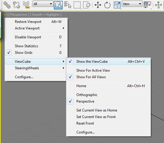

To display the Viewcube in Max 2009 or 2010, go to the upper left corner of the viewport and click on the little "+" symbol. Then select "Viewcube" and then check or uncheck "Show the Viewcube" depending on whether you want it to display or not.

I have 3ds Max 2010, and it has no viewcube, or the the little "+" symbol as shown in the picture, any other ideas on what could cause it to not be there?

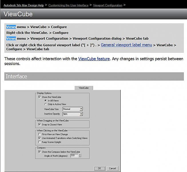

Go to the help files ans search "View Cube"
