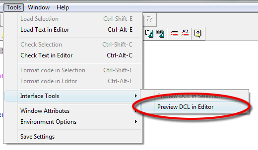

I have to take that back AutoCAD 2010 will load that routine but my dcl text box
will not come up in my routine. If you see anything in the above code that might
give a problem, please let me know. My lisp is rusty.
thank you,
Try this at the command line:
(findfile "paragh.dcl")
If it returns nil, then make sure you have the file in your support path and retry the LISP. :)
I will try that tomarrow sometime. I know the lisp routine works good on a stand alone
version but it has problems on a network version of 2010. The network verson has a lot
of junk on it making it slow. You know, Thing such as ribbons, etc.
I would give the complete routine but I can't remember which files goes together
to make the routine complete. I just make a support access directory to cover all
my routines. I think the above routine is a problem because the dcl is not coming
up. It puzzles me that it works on the stand alone version.
Why not just vlx the file with the lisp & dcl.
That way you never have to worrie about it, unless you delete the originals
Yes it is finding file (findfile "paragh.dcl")
at "C:\\PgCAD\\paragh.dcl" in a support path.
Is it possable that I might have variable interference because of a previous routine
being loaded in the network version? If so how can I tell what is being loaded to
cause a problem? In the old days I looked in Acad.lsp but now things have change.
Thank you,

Ok, The stand alone version of 2010 my programs works.
The network version it does not. Something must be different.
1. Could it be program speed?
2. Possable variable interferance with somthing preloaded on the network vers.
3. It also works on a network version on 2009 on the same computer but not on
the network version of 2010?
Any suggestions?
Thank you,
It there a way to make the dcl open on it own to see if it works.
