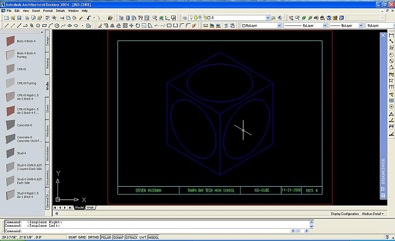

Shibuboss Posted August 23, 2009 Posted August 23, 2009 Hello everybody, In Isometric Snap mode, the " Circle " is not coming parrallel to the plane.what should be the reason? please advise. ( check the attachment) Thank you. Regards_____ Quote
CADMASTER1128 Posted August 23, 2009 Posted August 23, 2009 You can adjust the snap by hitting F5, that will switch the orientation of the circle being drawn.... Quote
Shibuboss Posted August 23, 2009 Author Posted August 23, 2009 Thanks for your replay, Did you try this method to draw circle.it's not working.instead of hitting " F5 " i used " ctrl+E ".but my friend it's not working.i am using autocad Lt.may be this could be the reason? or somethingelse? Thankyou. Regards______ Quote
CADMASTER1128 Posted August 23, 2009 Posted August 23, 2009 I have the cursor adjusted to fit the following circle. I used the F5 key as well... It works with my Architectural desktop.... See the attached image: Quote
Shibuboss Posted August 23, 2009 Author Posted August 23, 2009 Thanks for your replay, But it's still not working in Autocad Lt and autocad 2009.I have to adjust any settings.i tried both softwares.please advise.Thank you. Regards_____ Quote
SEANT Posted August 23, 2009 Posted August 23, 2009 Isometric circles can be generated through Ellipse-Isocircles. Command: _ellipse Specify axis endpoint of ellipse or [Arc/Center/Isocircle]: I Specify center of isocircle: Specify radius of isocircle or [Diameter]: Quote
Shibuboss Posted August 23, 2009 Author Posted August 23, 2009 Hi SEANT, Thanks a lot. Regards______ Quote
CADMASTER1128 Posted August 23, 2009 Posted August 23, 2009 Isometric circles can be generated through Ellipse-Isocircles. Command: _ellipse Specify axis endpoint of ellipse or [Arc/Center/Isocircle]: I Specify center of isocircle: Specify radius of isocircle or [Diameter]: Thanks for that!! This drawing is a year old I completely forgot that I used and ellipse! -Steven Quote
