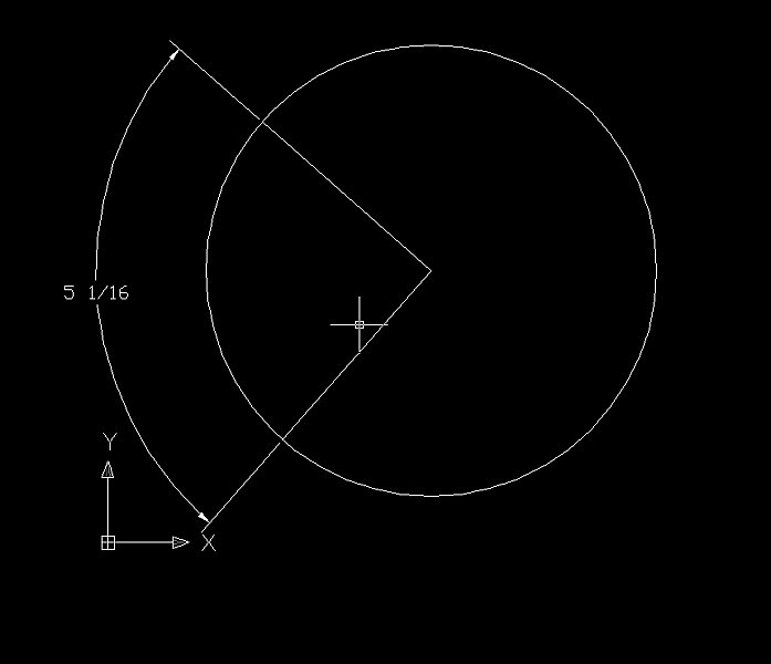

mdbdesign Posted August 18, 2009 Share Posted August 18, 2009 It is possible to get arc dimension as shown below without breaking circle apart, just selecting two points on circle??? Quote Link to comment Share on other sites More sharing options...
Lee Mac Posted August 18, 2009 Share Posted August 18, 2009 Yes, I believe this is possible through the use of the vlax-curve functions, specifically, vlax-curve-getDistatPoint. If you need further help, just shout. Lee Quote Link to comment Share on other sites More sharing options...
mdbdesign Posted August 18, 2009 Author Share Posted August 18, 2009 I use 2002 and was curious if Autodesk develop something in newer version to do it. Quote Link to comment Share on other sites More sharing options...
Lee Mac Posted August 18, 2009 Share Posted August 18, 2009 Well there is Arc-Length dimensioning, but, of course, it only works on arcs... As for the LISP alternative: (defun ArcLen (Ent pt1 pt2) (abs (- (vlax-curve-getDistatPoint Ent Pt2) (vlax-curve-getDistatPoint Ent Pt1)))) Quote Link to comment Share on other sites More sharing options...

mdbdesign Posted August 18, 2009 Author Share Posted August 18, 2009 Thanks Lee now I will try to incorporate two lisp routine to get me result as on picture in first post. Attached is dimarc lisp. What you think ? Will work?? DIMARC.LSP Quote Link to comment Share on other sites More sharing options...
Lee Mac Posted August 18, 2009 Share Posted August 18, 2009 The DIMARC command will only allow an arc/polyline seg input - so no, I don't think that will work, unless you created a temporary arc, dimensioned it, then deleted it. Quote Link to comment Share on other sites More sharing options...
mdbdesign Posted August 18, 2009 Author Share Posted August 18, 2009 That is what I did so far. Got another lisps that divide circle on section and change layer of selected part to Hidden (yours) and another that create circle out of arc. So if I combine it in macro it should work. Quote Link to comment Share on other sites More sharing options...

Lee Mac Posted August 18, 2009 Share Posted August 18, 2009 Something like this perhaps M? (defun c:DimCir (/ doc spc ent p1 p2 ax cen) (vl-load-com) (setq doc (vla-get-ActiveDocument (vlax-get-Acad-Object)) spc (if (zerop (vla-get-activespace doc)) (if (= (vla-get-mspace doc) :vlax-true) (vla-get-modelspace doc) (vla-get-paperspace doc)) (vla-get-modelspace doc))) (if (and (setq ent (car (entsel "\nSelect Circle: "))) (eq "CIRCLE" (cdr (assoc 0 (entget ent)))) (setq p1 (getpoint "\nPt1: ")) (setq p2 (getpoint "\nPt2: "))) (progn (setq ax (vla-addArc spc (vlax-3D-point (setq cen (cdr (assoc 10 (entget ent))))) (cdr (assoc 40 (entget ent))) (angle cen p1) (angle cen p2))) (vlax-invoke spc 'adddimarc cen p1 p2 p1) (vla-delete ax) (vl-cmdf "_.dimtedit" (entlast) pause))) (princ)) Quote Link to comment Share on other sites More sharing options...

mdbdesign Posted August 18, 2009 Author Share Posted August 18, 2009 Made button: ^C^C(load "brcirc") _brcirc \\\^C^C_(load "dimarc") -la;set;dimension;;_dimarc \\ _erase;\ ^C^C_(load "a2c.lsp") _a2c and all lisp file attached. Work like charm. Something like this perhaps M? I got 2002 onlybrcirc.lsp DIMARC.LSP A2C.LSP Quote Link to comment Share on other sites More sharing options...
