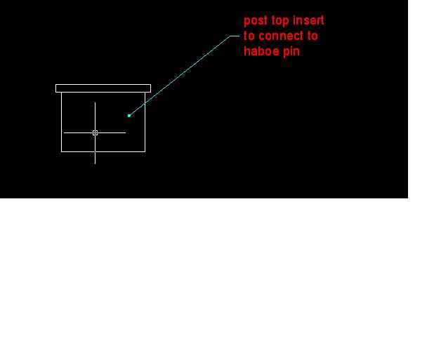

stevsmith Posted August 17, 2009 Posted August 17, 2009 I would like to try and set up a Multileader that reads the description of a block. For example when I am making the block I would like to put some descriptive text that may say "Post top insert connected to haboe pin" After the block is compelted and placed into a new drawing I would then select the multi leader option and then it would automtically fill in the text. (from the pre-defined description) I would like it to be similar to a callout in solidworks. Quote
alanjt Posted August 17, 2009 Posted August 17, 2009 not too terribly difficult: (defun c:TEST (/ #Entsel #InsPoint #Name #Desc #LandPoint) (if (setq #Entsel (AT:Entsel nil "\nSelect block: " '((0 . "INSERT")) nil) ) ;_ setq (progn ;; convert to vla-object (setq #Entsel (vlax-ename->vla-object (car #Entsel)) ;; insertion point #InsPoint (vlax-safearray->list (vlax-variant-value (vla-get-InsertionPoint #Entsel) ) ;_ vlax-variant-value ) ;_ vlax-safearray->list ;; block name #Name (vla-get-name #Entsel) ;; block description #Desc (vla-get-comments (vla-item (vla-get-blocks (vla-get-activedocument (vlax-get-acad-object)) ) ;_ vla-get-blocks #Name ) ;_ vla-item ) ;_ vla-get-comments ) ;_ setq (cond ;; no description in block ((eq "" #Desc) (princ (strcat "\nNo description for block: \"" #Name "\"" ) ;_ strcat ) ;_ princ ) ;; specify leader landing location ((setq #LandPoint (getpoint #InsPoint "\nSpecify leader landing location: " ) ;_ getpoint ) ;_ setq (vl-cmdf "_.mleader" "_non" #InsPoint "_non" #LandPoint #Desc) ) ) ;_ cond ) ;_ progn ) ;_ if (princ) ) ;_ defun you'll need this subroutine: ;;; Entsel or NEntsel with options ;;; #Nested - Entsel or Nentsel (T for Nentsel, nil for Entsel) ;;; #Message - Selection message (if nil, "\nSelect object: " is used) ;;; #FilterList - DXF ssget style filtering, no cons (nil if not required) ;;; #Keywords - Keywords to match instead of object selection (nil if not required) ;;; Example: (AT:Entsel nil "\nSelect MText not on 0 layer [settings]: " '((0 . "MTEXT")(8 . "~0")) "Settings") ;;; Alan J. Thompson, 04.16.09 ;;; Updated: Alan J. Thompson, 06.04.09 (changed filter coding and added layer option) (defun AT:Entsel (#Nested #Message #FilterList #Keywords / #Count #Message #Choice #Ent ) (setvar "errno" 0) (setq #Count 0) (or #Message (setq #Message "\nSelect object: ")) (if #Nested (setq #Choice nentsel) (setq #Choice entsel) ) ;_ if (while (and (not #Ent) (/= (getvar "errno") 52) ) ;_ and (and #Keywords (initget #Keywords)) (cond ((setq #Ent (#Choice #Message)) (and #FilterList (vl-consp #Ent) (or (not (member nil (mapcar '(lambda (x) (wcmatch (if (eq (type (cdr (assoc (car x) (entget (car #Ent)))) ) ;_ type 'STR ) ;_ eq (strcase (cdr (assoc (car x) (entget (car #Ent)))) ) ;_ strcase (cdr (assoc (car x) (entget (car #Ent)))) ) ;_ if (cdr x) ) ;_ wcmatch ) ;_ lambda #FilterList ) ;_ mapcar ) ;_ member ) ;_ not (setq #Ent nil) ) ;_ or ) ;_ and ) ) ;_ cond (and (= (getvar "errno") 7) (not #Ent) (setq #Count (1+ #Count)) (prompt (strcat "\nNope, keep trying! " (itoa #Count) " missed pick(s)." ) ;_ strcat ) ;_ prompt ) ;_ and ) ;_ while #Ent ) ;_ defun Quote
stevsmith Posted August 18, 2009 Author Posted August 18, 2009 What do I do with the second script? i get this error Select block: ; error: no function definition: VLAX-ENAME->VLA-OBJECT Quote
alanjt Posted August 18, 2009 Posted August 18, 2009 What do I do with the second script? i get this error Select block: ; error: no function definition: VLAX-ENAME->VLA-OBJECT just put it in the .lsp file with the other. i always forget to add (vl-load-com) because i have it it my startup file. here, i'll just put it together for you: TEST.lsp Quote
stevsmith Posted August 18, 2009 Author Posted August 18, 2009 Thanks Alan. That is exactly what I'm looking for. I'm trying to learn lisp myself. Lee gave me hundreds of tutorials to muck around with, but I'm trying to get back into Solidworks to look for new employment, so the lisp has been sidelined just now. i thought that there was maybe an option in the cui or setup i could have changed to do this. But this lisp is everything Im looking for. Thanks again mate. Quote
alanjt Posted August 18, 2009 Posted August 18, 2009 Thanks Alan.That is exactly what I'm looking for. I'm trying to learn lisp myself. Lee gave me hundreds of tutorials to muck around with, but I'm trying to get back into Solidworks to look for new employment, so the lisp has been sidelined just now. i thought that there was maybe an option in the cui or setup i could have changed to do this. But this lisp is everything Im looking for. Thanks again mate. happy to help had a few minutes last night and i was curious how to access the comments on a block (took a little research). btw, this will exit and prompt you if the block does not have a description. Quote
