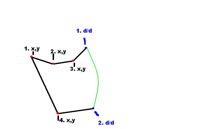

I mean after a "LINE" command and entering in my 5 absolute x-y coordinates lines are nowhere to be seen.
Here is what I have in ArcMap:
I want to get the 4 x-y plotted, so I can use my distance and degree's to get my start and end point of my arc.
The damn lines won't show in AutoCad though.
So you have four points, each point having one set of xy coordinates if I follow you correctly.
What do your entries look like for each line end point? Please don't mistake my question to be an insult to your knowledge and skills. I find it easier to troubleshoot a problem knowing how someone goes about doing a particular thing.
If I could get this guy in AutoCad I'd be halfway done. :)

So at the command line your entry for each end point for the line would look like this:
Command: Line
Specify first point: 3150380.25,696827.68
Specify next point or [undo]: 3150441.93,696896.81
...and it continues on as such until you end the command. Make sure there is no spaces between the x and y coordinate. Bearings and distances are not needed with absolute coordinate entries.

Here you go:
now once I'm at this point, my only options are to: "Close/Undo"
I would like to do neither. I want to: Stop. Find those Lines I've made(They seem to disappear when I search for them) and then add distance and direction to them.
Here you go:
Then press the Enter key to end the Line command and do a zoom extents (if that is all thats in your drawing) to find the lines. The Close/Undo means your in a polyline command which by pressing Enter will also end the command without closing the polyline or undoing it.

THANKYOU!
That has solved my disappearing polyline problem.
Now if anyone could help me pindown my error when I try to paste that soon-to-be polygon onto the ArcMap polygon...
OK here is what I now have:
1. I have created a polygon out of those x,y coordinates using the 'bpoly' command.
2. I have opened ArcCatalog, created a new geodatabase, and imported a new polygon feature class from the AutoCad file.
3. I have applied the predifined x-y coordinate system of the polygon I wish to paste to: NAD_1927_StatePlane_Texas_South_Central_FIPS_4204 from
4. I drag my new feature class into ArcMap. And....
5. Success!
Thanks to ScribbleJ. And everyone else who helped.
