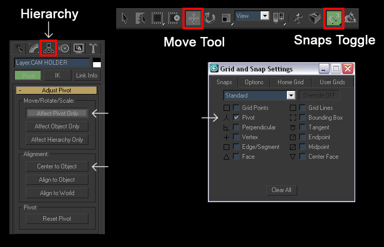

You can use object snaps in Max to position objects in much the same way you do in Autocad.
Here's what I would suggest, in order for you to align the cam holder onto the camshaft:
1. Center the cam holder pivot point.
  • Click on the cam holder, to select it.
  • Go to the "Hierarchy" panel
  • Under the "Adjust Pivot" section, select "Affect Pivot Only". Then click "Center to Object" and then click "Affect Pivot Only" again to close out.
2. You can now easily move the cam holder onto the camshaft by using the Move tool and your object snaps.
  • Select the Move tool and then enable your object snaps by clicking the "Snaps Toggle" button.
  • Right click on the button to open the "Grid and Snap Settings" dialog.
  • On the "Snaps" tab, clear all options except for the "Pivot" option and then close the dialog.
  • Click the cam holder to select it. Your Transform Gizmo will appear in the center of the object.
  • Grab the gizmo in the YZ plane. You will see the little square at the intersection of the YZ plane light up yellow when your cursor hovers over it.
  • Once the little square lights up yellow, click and hold with your left mouse button and then drag over to the cam shaft.
  • When your cursor hits the cam shaft, you will see a bounding box appear around the shaft and you will also see a little upside down Y appear at the midpoint of the shaft. Drag your cursor over to that symbol. Once your cursor hits that upside down Y, your cam holder will snap into position, centered perfectly on the shaft.
You can use the same procedure to position the bearing sleeve onto the cam shaft.
Hope this helps. Post back if you have any more trouble.
