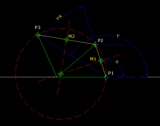

Being curious as I am... just had to dissect your method Gile... :P
Here is my diagram for others to benefit :)
A slight twist on it:

(defun c:test (/ p1 p3)
 (if (and
       (setq p1 (getpoint "\nSpecify the first point: "))
       (setq p3 (getpoint p1 "\nSpecify the second point: "))
       (not (equal p1 p3))
       (princ "\nSpecify the third point: ")
   (gr-3PointsArc p1 p3)
