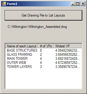

SEANT Posted August 16, 2009 Share Posted August 16, 2009 I believe this issue has already been resolved but figured I post an example anyway, even if only to give the thread some additional value to future searches. The attached is an example of a standalone .NET exe processing a DWG file via Interop. The routine selects/opens a drawing file to list layouts and VP quantities. The files are opened with ObjectDBX so are not present in the AutoCAD drawing editor, though AutoCAD does need to be open. As always with example routines, test on non consequential files. Edit: Fixed bug in attachment GetAcadVPs_rev1.zip Quote Link to comment Share on other sites More sharing options...
PellaCAD Posted August 20, 2009 Author Share Posted August 20, 2009 Good morning Seant... I made some good progress using the ListLayoutVPs and CollectViewPorts subs...I added a debug.print to get the program to list the PViewPort ObjectID and the containing layout name. (It really works flawlessly!) eg PViewport objectID "2122446976" resides on layout E(04) PViewport objectID "2113999800" resides on layout E(05) PViewport objectID "2114773808" resides on layout E(06) PViewport objectID "2114776744" resides on layout E(07) PViewport objectID "2125253152" resides on layout E(08) The program seems to only collect the Primary ViewPort on each layout tab... The task now, is to go through each layout tab and collect the simple ViewPorts. Do we look inside each PViewPort? Or is accessing simple ViewPorts accomplished in some other manner?? Thanks again Seant for helping me break through what had become a rather significant log jam. If we can get this last piece unscrambled, I think I am on my way. Pete Quote Link to comment Share on other sites More sharing options...
SEANT Posted August 20, 2009 Share Posted August 20, 2009 . . . . . The program seems to only collect the Primary ViewPort on each layout tab... The task now, is to go through each layout tab and collect the simple ViewPorts. . . . . . Pete The routine is only returning the Main Layout ViewPort and none of the floating Viewports? That’s odd. I set the code up to include all viewports except the layouts main VP. And everything appears to be working as it should on my end. See attachment. I did just notice that I forgot to zero the “widest” variable within the layouts For Each loop (I’ll post a correction shortly). Is a repeated value for widest the reason it appears to exclude the floating viewports? Quote Link to comment Share on other sites More sharing options...
