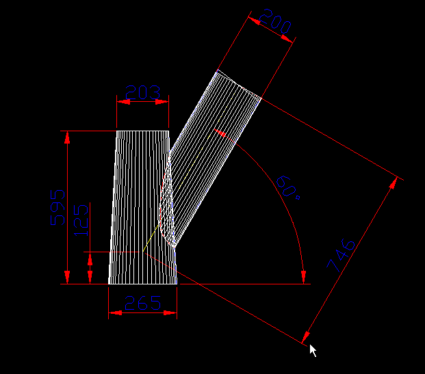

mdbdesign Posted August 12, 2009 Posted August 12, 2009 Use reduction or something like on picture Quote

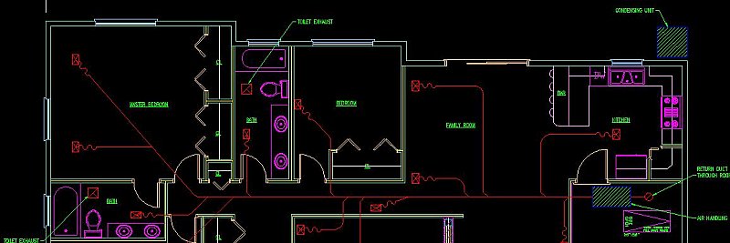

CADMASTER1128 Posted August 12, 2009 Posted August 12, 2009 I don't know if this will help, but this is how I draw my HVAC ducts. Drawing organically drawn by StykFace. Quote

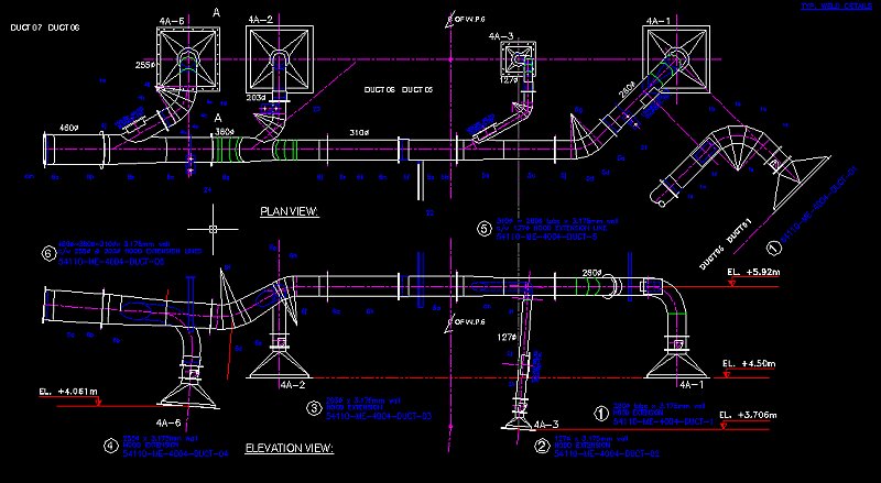

mdbdesign Posted August 12, 2009 Posted August 12, 2009 ...or something like this: (just learn how to add picture:-))) ) Quote
chelsea1307 Posted August 12, 2009 Posted August 12, 2009 learn something new everyday, ive never seen branch off a reducer Quote
tzframpton Posted August 12, 2009 Posted August 12, 2009 chelsea1307 said: learn something new everyday, ive never seen branch off a reducer This is very common in the HVAC industry. Granted its a custom fitting that usually costs more which can drive up bid price, but for very widely used sizes, this is definitely common. Quote
