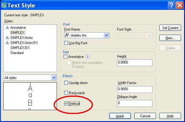

I am using Autocad 2007. I have a project that requires a specific font (Arial Narrow Bold), the tricky part ...I need the text vertically...no rotating...just like any asian language...
The vertical box option is not available. I have read that fonts that allow to be written vertically are the ones that start with @....Any ideas where can I find this type of fonts and how are they called?
Or if there is a way to write vertically any font similar to the Arial Family??...:?

That is what I do when I need vertical text.
You could always make a new style, makes for easier editing.
I totally agree with the making a new style suggestion but what if the font itself (TrueType) does not support the vertical option?
Good tip. Will keep that in my bag of tips an tricks.
I probably wouldn't use it then.
Any way to force the font via lisp to "assume the position"?
Ask Lee Mac, he seems to have a slow down in the LISP world.
This will set it for you, but only if you can.

Did you supply the correct TextStyle argument?
Does the font in the TextStyle allow for Vertical?
What error are you getting, if any?
I don't think TTF fonts support Vertical effects.
I agree, only shape files. (.shx)
