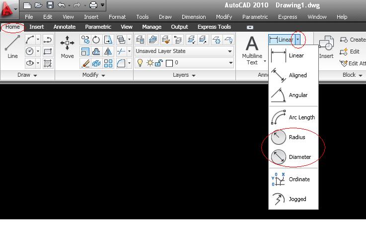

DMD64 Posted August 9, 2009 Posted August 9, 2009 Fellas, I am trying to get up to speed with this new release. For those of you who have launched 2010 you can see that the interface has changed and many new features have been added . Some tools are not where they used to be and although I can always rely on command line entry to dim a diameter or radius, I would like to know if anyone has found where the icon for these commands now resides? Quote
DMD64 Posted August 9, 2009 Author Posted August 9, 2009 Why under Linear Dimension when its used to call out diameters and radius? Thanks for the reply. Quote
stevsmith Posted August 9, 2009 Posted August 9, 2009 To be perfectly honest I have my all the dimensions that I use in my tool pallet. I also don't use the ribbon anymore as I found it to distracting. I've went back to the classic autocad pallet. But you will notice that when you select the radius tool and use it the flyout menu name changes from Linear Dimension to Radius Dimension. It is not grouped under any specific group. If you know what I mean Quote
DMD64 Posted August 11, 2009 Author Posted August 11, 2009 The interface looks much different than the standard layout I have become so accustomed to over the years. Ribbons, steering wheels, the absense of toolbars upon startup, pull down menus gone or moved, etc. these are making 2010 a little cumbersome to work with at this point. Probably a reason for the changes so I want to get familiar with them instead of going back to my toolbars and command line entry right away. One really interesting feature is the directional model that appears when you are in 3D. Very handy to have when you are walking around a part getting all the features in place. thanks again Quote
