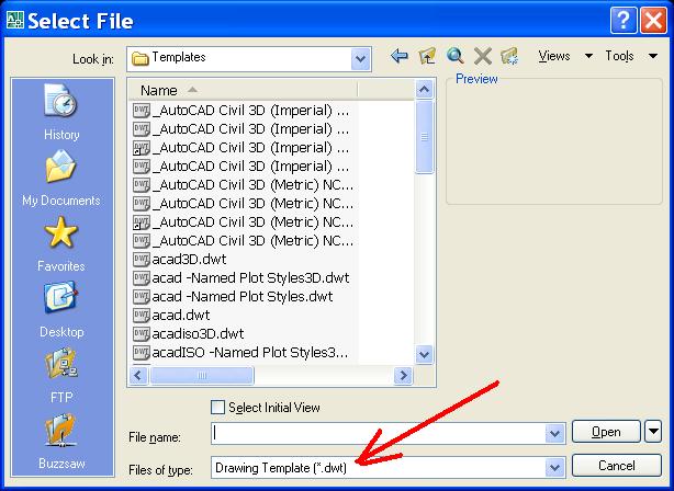

You can open a .dwt just as a .dwg.
From the Open dialog box
