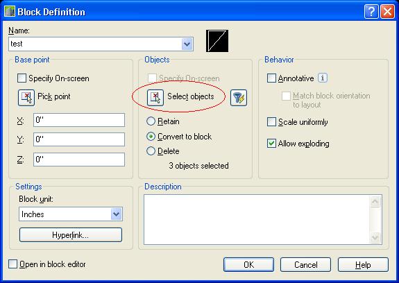

CADMASTER1128 Posted August 7, 2009 Posted August 7, 2009 Copying Layer(s) into a new drawing: To copy a set of layers in a current drawing (DRAWING A) into another drawing (DRAWING B), Select the parts (layers) of the drawing you wish in "import" or copy. Right Click, copy and then paste DRAWING A into DRAWING B. By coping and pasting, this will bring the layers and there properties in to the drawing (DRAWING B) you pasted them in. Creating a block: As seen in the command line: Command: b BLOCK Select objects: Specify opposite corner: 3 found Select objects: Command: *Cancel* Type B in the command line. Call the block what you want. Click, Select Objects. Then OK Now you have created a block. (For extra help see images attached). Quote
steve 'o' Posted August 7, 2009 Author Posted August 7, 2009 Godknows whats happening i cant seem to get it to work!! Work over for the day i will try again on Monday, Thanks for help! Select objects: Specify opposite corner: 3 found = I assume i can just highlight the area i want? I have done this but it does not paste, I assume i need to paste witth a specific point on both so they overlay in correct place? Quote
CADMASTER1128 Posted August 7, 2009 Posted August 7, 2009 Highlight the object you want. In my example I had 3 objects. Make sense? Quote
