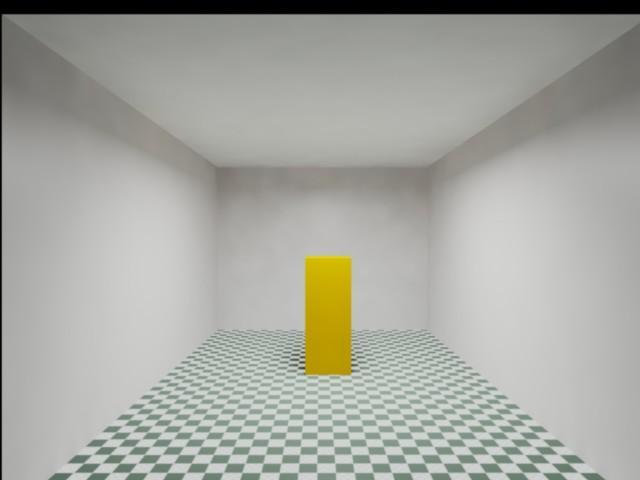

omid_221 Posted August 12, 2009 Author Posted August 12, 2009 thanks papagyi. but another bug i think found in auto cad. do u know reflection map done not influence on reflection? for example put checker map on reflection channel. as you anticipate whit color should reflect and black colors shouldn't.but it has no effect!!!!!!! Quote
papagyi Posted August 12, 2009 Posted August 12, 2009 Your bug means like this? I did diffuse color for green & reflection map with checker( black & white)! Quote
omid_221 Posted August 13, 2009 Author Posted August 13, 2009 nope that not. when you put gray scale map on reflection channel you expect areas in texture with dark colors has no reflection and in opposite bright colors reflect surrounding scene . Quote
papagyi Posted August 13, 2009 Posted August 13, 2009 ya..you right! My image showed as you said! r without environment reflection.Is is Bug?..we need to suggest to autodesk for this problem! So i already said you above ! Quote
omid_221 Posted August 13, 2009 Author Posted August 13, 2009 OK lets see this!! mat assigned to plan and daylight with FG are on diffuse=blue reflection=checker file uploaded too Drawing1.dwg Quote
papagyi Posted August 13, 2009 Posted August 13, 2009 Can you change 2008 file type fri? :(I already have 2008 now! Quote
papagyi Posted August 13, 2009 Posted August 13, 2009 You need to use opacity map fri! But we lose environment reflection! checker.dwg Quote
omid_221 Posted August 14, 2009 Author Posted August 14, 2009 where is the reflection of red box!!!!!! Quote
papagyi Posted August 14, 2009 Posted August 14, 2009 we lose environment reflection.Is is Bug?..we need to suggest to autodesk for this problem! So i already said you above ! Quote
