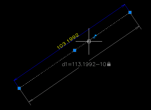

Lee Mac Posted August 5, 2009 Posted August 5, 2009 I think you can in 2010: http://rcd.typepad.com/rcd/2009/02/autocad-2010---its-parametric.html Quote
