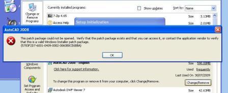

I resigned to the fact that as all the versions in that particular folder were corrupt, it might be an AutoCAD problem and thought I could insert the disc and repair. When I tried I got an error message (see attached - Acad Disc Load) and it failed.

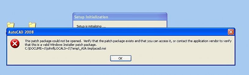

I then thought I would uninstall and start again - but again it displayed and error message and failed (see attached - Acad uninstall).

What is this "patch package" mentioned in the error message? Did you try to load an update, or a hot fix for AutoCAD itself or did you try to "patch" a problem with an add-on program?
No idea what 'patch package' meant, thats why I thought something must be corrupt in the registry or with the installation and trying a repair or reinstall would fix it.

I'm suspicious to the reference in the error message re: acad.msi file.

If you do a complete uninstall and reinstallation look in the Useful Links forum. I posted a link to the AutoDesk website where you'll find an article on how to go about doing a proper uninstall. It might help.
