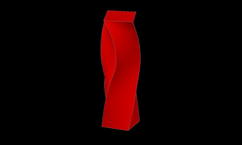

wh33lz Posted May 14, 2008 Author Posted May 14, 2008 chrisdarmanin said: i managed that with sweep command but for a strange reason it will not take 1800 degrees twist (5 turns or any number of complete turns) but it takes any other angle. very strange indeed Thats an awesome diagram, exactly what I was after, but unfortunately I must have something fundamentally wrong with my procedure, because it still extrudes straight, even at any angle. My procedure is this: I draw a 12 x 12 square on the x/y plane > Add a line at a set length (eg 750mm) starting from the centre of the square along the z plane> Choose the sweep command> Select the square> Set the twists at any angle other than a full turn (eg 9365 degrees, which is slightly over 26 turns)> Select the path (line at 750 long on the z plane)> It extrudes straight as a die??? I obviously doing something wrong.. just cant figure it out? edit- Ok i think I figured it out, If the path lies on the same plane as the object to be extruded, ie all on the xy, it works. But the angle modifier isnt intuitive at all, if you increase the angle (intuitively adding 360 degrees for each full turn) it starts playing some funny tricks. ie, I tried 19020 degrees over 120 mm and it turned only about 10 degrees, but if I try 2100 degrees over the same distance, I get about 270 degrees. strange indeed. I'll endeavour to figure out how this can be manipulated to get the desired result, but all in all it seems odd. 2nd Edit- Ok I tried 270 degrees and get an almost exact result as 2100. Im thinking it will only twist through 360 or increments thereof. Only way to be sure is try out many different lengths and angles untill I get a controllable procedure. Quote

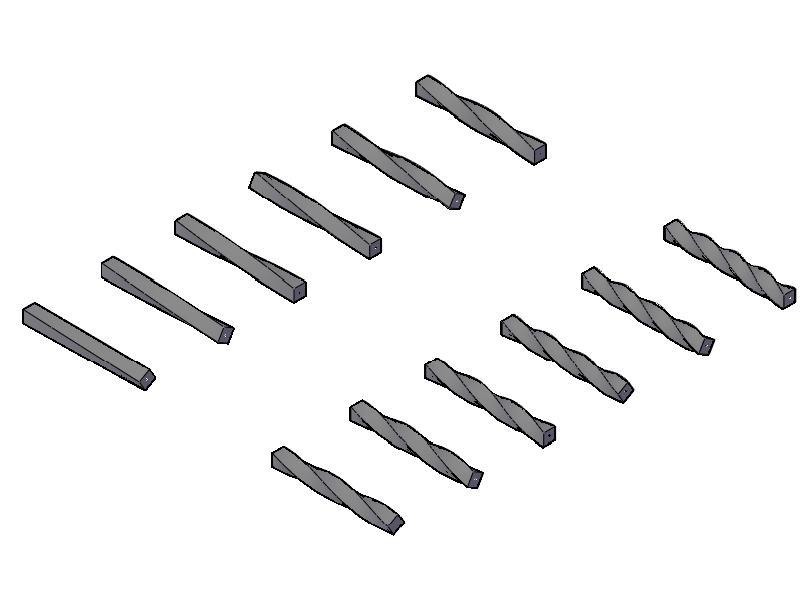

wh33lz Posted May 14, 2008 Author Posted May 14, 2008 Heres a few twists in 30 degree increments, you can twist at 359 degrees which will give 1 full twist, but thats it. Any more than 359 goes back to 0 degee, then 1 degree etc.. Only way to get 5 twists over a set distance is divide the distance into 5, twist that section and unite them into a single object. Quote
chrisdarmanin Posted May 14, 2008 Posted May 14, 2008 Quote edit- Ok i think I figured it out, If the path lies on the same plane as the object to be extruded, ie all on the xy, it works.But the angle modifier isnt intuitive at all, if you increase the angle (intuitively adding 360 degrees for each full turn) it starts playing some funny tricks. ie, I tried 19020 degrees over 120 mm and it turned only about 10 degrees, but if I try 2100 degrees over the same distance, I get about 270 degrees. strange indeed. I'll endeavour to figure out how this can be manipulated to get the desired result, but all in all it seems odd. 2nd Edit- Ok I tried 270 degrees and get an almost exact result as 2100. i had all those problems Quote Heres a few twists in 30 degree increments, you can twist at 359 degrees which will give 1 full twist, but thats it. Any more than 359 goes back to 0 degee, then 1 degree etc.. Only way to get 5 twists over a set distance is divide the distance into 5, twist that section and unite them into a single object. that seems to be the best bet thanks for your persistance to solve the problem Quote
