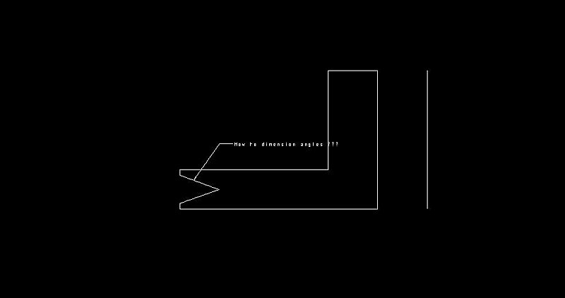

cad_student Posted July 28, 2009 Posted July 28, 2009 Hi, I am currently learning Autodesk Inventor,But have hit a snag...The problem is how to create angled line's,I need to create 20 deg angle lines in the example drawing below but am struggling to do so.Any help is greatly appreciated. Quote

czc Posted July 29, 2009 Posted July 29, 2009 Attach your file here. What release of Inventor are you using?Have you gone through these tutorials? http://home.pct.edu/~jmather/AU2006/MA13-3%20Mather.pdf and slightly different http://home.pct.edu/~jmather/AU2007/MA105-1L%20Mather.pdf Don't you just select dimension [D] and then click both the lines and type the angle you want? Quote
cad_student Posted July 29, 2009 Author Posted July 29, 2009 Attach your file here. What release of Inventor are you using?Have you gone through these tutorials? http://home.pct.edu/~jmather/AU2006/MA13-3%20Mather.pdf and slightly different http://home.pct.edu/~jmather/AU2007/MA105-1L%20Mather.pdf Hello JD, I am using Inventor 2009 and need to place and dimension the 2 lines at 20 deg angle's,How would i do that??,i have also saved your exellent tutorials and will go through them soon,Prehap's you should write a book,I am currently learning from -Learning and applying autodesk inventor 2009 by L scott hansen ph.D.) a great book so far but left me guessing on how to accuratly create angled lines then dimension them???,Although i have been using rotate to create the angled line's but still struggle with the dimension side of things??,Any quick and to the point answer's greatly appreciated!!. Quote
cad_student Posted July 29, 2009 Author Posted July 29, 2009 Don't you just select dimension [D] and then click both the lines and type the angle you want? Hi and many thank's for your response,I will try your suggestion. Quote
JD Mather Posted July 29, 2009 Posted July 29, 2009 Don't you just select dimension [D] and then click both the lines and type the angle you want? Might want a Symmetry constraint to control the angle in addition to the dimension. Quote
JD Mather Posted July 29, 2009 Posted July 29, 2009 ..Although i have been using rotate to create the angled line's Sounds like you are trying to use Inventor like it was AutoCAD. Forget about trying to rotate - I have never used that. In Inventor you are sketching just like freehand on a sheet of paper with a pencil. Do not bother to try to get exact or even particularly close. Do your sketch and then add dimensions and constraints to get it exact. (I recommend sketching one line and dimensioning it immediately to give a sense of scale to the rest of the sketch.) Don't put off reading those pdf documents - do it now. Quote

cad_student Posted July 29, 2009 Author Posted July 29, 2009 Don't you just select dimension [D] and then click both the lines and type the angle you want? Yep easy!! that worked for me Many thank's for your cut to the chase response:). Quote
