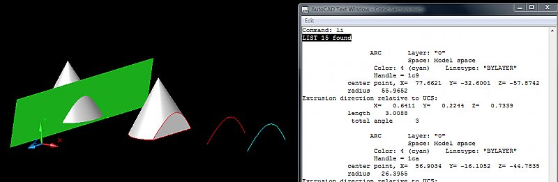

Are you familiar with Flatten and Explode and List commands?
I don't think I would fool with Eldon's suggestion on this problem. I suspect there is an easier solution. Attach your file here.
Excel file of 128 points
If you understand the conic section geometry you don't need all of those points.
In fact if you attach your solution here I suspect that I can show more (user calculated) points actually equal less accurate curve.
Xedges command creates the spline from the conic section.
Flatten (Express Tool command)
Explode (in this case I converted to 15 arcs - there is a method to control the number of arc resolution but I forget at the moment - hollar back if you can't figure it out).

Make a Spline and when asked for the tangent directions at start and finish, just press Enter in response to both. THEN flatten the Spline, which turns the Spline into a Polyline. (confusing isn't it!!)
