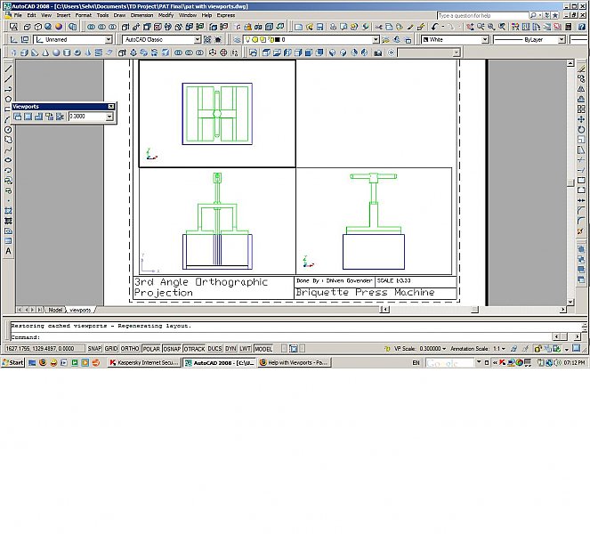

grandmaster87 Posted July 25, 2009 Posted July 25, 2009 how do i get rid of the 4th space there... its a viewport but i dont need it in my drawing... the 4th one is the one of the bottom right hand side in isometric Quote

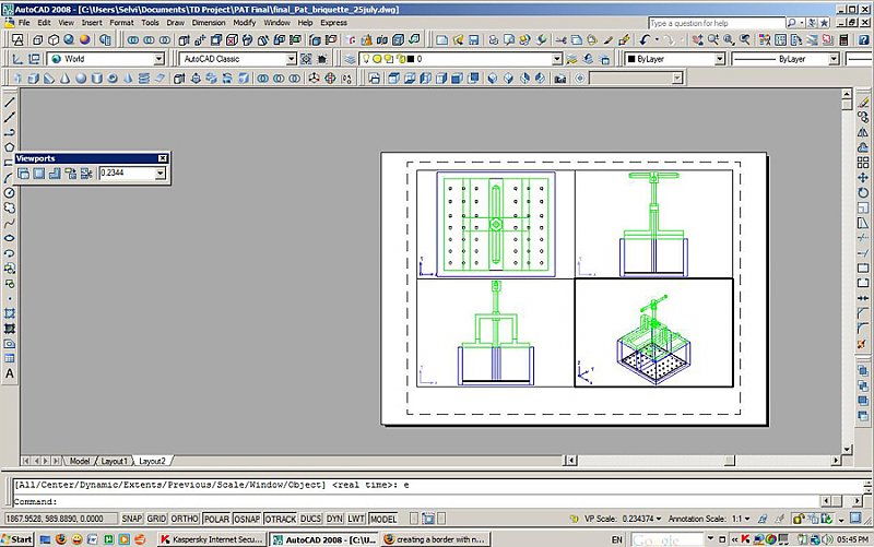

grandmaster87 Posted July 25, 2009 Author Posted July 25, 2009 thanks bro...i seem to have a problem. look at my top view..from the top you wont be able to see those holes..but when i try and delete them they are removed from all the other viewports? i really need to finish this cad tonight Quote
Cad64 Posted July 25, 2009 Posted July 25, 2009 The holes are on their own layer, correct? So just activate the "Top View" viewport and freeze the "holes" layer in that viewport. They will still be visible in the other viewports. If the holes are not on their own layer, create a new layer, move the holes to the new layer and then freeze the new layer in the viewport. Quote

grandmaster87 Posted July 25, 2009 Author Posted July 25, 2009 The holes are on their own layer, correct? So just activate the "Top View" viewport and freeze the "holes" layer in that viewport. They will still be visible in the other viewports. If the holes are not on their own layer, create a new layer, move the holes to the new layer and then freeze the new layer in the viewport. thanks it works. Quote

grandmaster87 Posted July 25, 2009 Author Posted July 25, 2009 i just froze the layer in the selected viewport and the drainage holes went away cause i assigned them to a layer. Quote

grandmaster87 Posted July 25, 2009 Author Posted July 25, 2009 see the holes are not visible .. all i need to do now is get a front sectioned view and i will be done Quote
