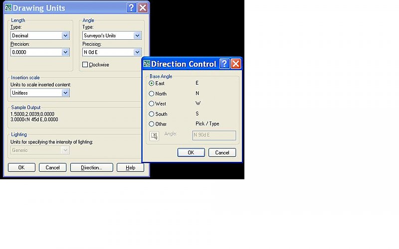

lpseifert Posted July 24, 2009 Posted July 24, 2009 I think you need 10 posts before you can attach a file. (you could make a few new posts), the go to the 'Go Advanced' button at the bottom of the page > Manage Attachments and attach the .dwg file (you may need to zip it first, if it's bigger than the size limitations). One other thought, do your Units setting resemble the attached? Quote
CADTEX Posted July 24, 2009 Author Posted July 24, 2009 I think you need 10 posts before you can attach a file. (you could make a few new posts), the go to the 'Go Advanced' button at the bottom of the page > Manage Attachments and attach the .dwg file (you may need to zip it first, if it's bigger than the size limitations).One other thought, do your Units setting resemble the attached? It is the same save for the Angle Type being Degree/Minute/Second rather than the Surveyor's Units. I could try it in Surveyor Units though I never have... what is the format for entering DDMMSS when the Angle Type is Surveyor's Units? I'm still flumoxed!!!! Quote
lpseifert Posted July 24, 2009 Posted July 24, 2009 It's probably the same as you've been doing... To enter a line 100' long @ N45d45' 30"E. you'd enter @100 I was more concerned with the Direction Control than units. Is the Base Angle East = E (and not Other)? Quote
CADTEX Posted July 24, 2009 Author Posted July 24, 2009 It's probably the same as you've been doing...To enter a line 100' long @ N45d45' 30"E. you'd enter @100 I was more concerned with the Direction Control than units. Is the Base Angle East = E (and not Other)? still no dice. I started a new drawing and line by direction works as usual, no hiccups. The new drawing has the following: ANGBASE 0d0'0" UNITS has Angle type of D/M/S and a Direction of East. In short, everything worls fine in a new drawing, same as I have done for years. However, this client drawing is screwy like I have not seen. Since I'm on my own here, I need to figure it out and no luck so far. This has really got me worked up! Quote
