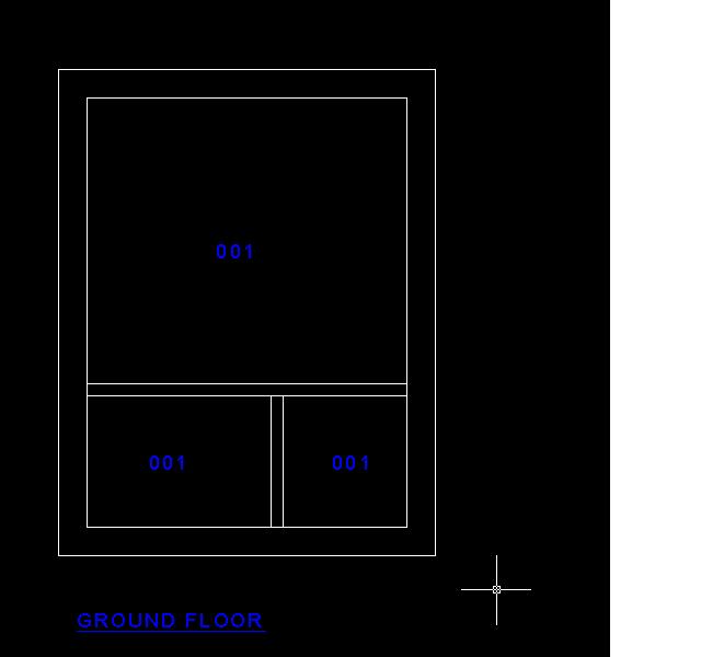

stephenward Posted July 24, 2009 Posted July 24, 2009 i draw basic/ diagramatic/ thumbnail cad drawings of floor plans. (see attached) can acad LT 2008 draw double lines or would i have to use offset to acheive this. i heard acad architectural desktop will draw insulated cavity walls in one swoop & wondered if LT can to a stripped down equivalent. Quote
ReMark Posted July 24, 2009 Posted July 24, 2009 While I know LT does not have a Multiline command doesn't it have one called DLine? Just confirmed it myself. DLine has been a feature of AutoCAD LT since 2002. What version are you using? Quote
stephenward Posted July 24, 2009 Author Posted July 24, 2009 dline? i'll have a look thanks, i'm acad lt 2008 Quote
