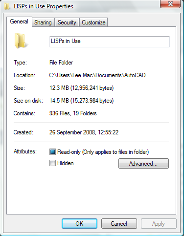

Just curious Lee. How many LISP routines, VBA, etc. do you think you have written so far?
If you are going to give away all your code to anyone and everyone that comes along and either asks (mostly) or demands (on rare occassion) then you might as well consider a different career and write code as a hobby. You don't know someone at school who can set up a website for you or show you how to go about it yourself?
Quite a few, these are just the ones I can be bothered to save, more inside subfolders also...
I never said I will just give aways all my code - I know that I write a few codes for those that request them, but I think this is going to change. Even if I set up a website (a friend of mine could do this for me), and charged, say £3-£5 for a LISP routine, that would soon mount up and would not be extortionate.
I am not really considering this as a job, but rather keep it as a hobby - I will see where my Maths degree takes me.
Lee
Thank you for clearing that up for me. I thought you were leaning towards programming. BTW...that's a lot of files. Do you ever sleep? And when you do, do you dream in code or of code? :)
Well, at the minute, programming is a hobby/interest of mine - my main focus is (or should be!) my maths degree, which I hope will put me in good standing for job when this recession clears up... :wink:
A lot of files indeed... I really need to clear it up - some are from when I very first started and are very simple. But most of the time, with a new request, I find I have already written the base of the code in the past, and just need to tweak it :P
Lee
